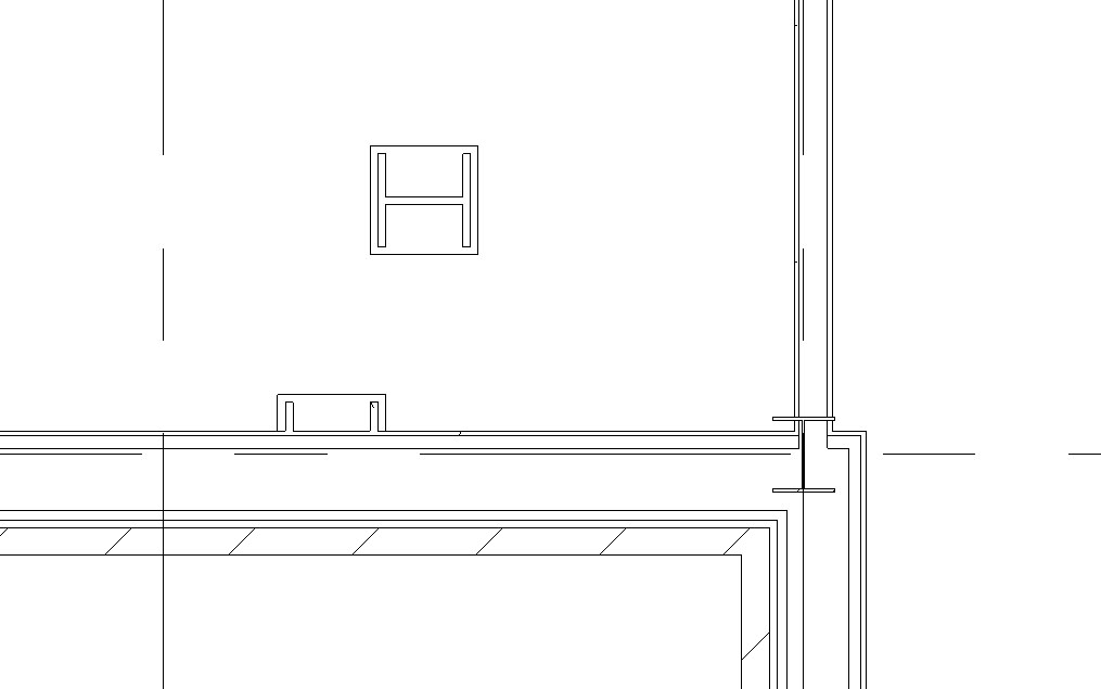

Hey all, I've created a new column family (using the column template) and loaded it into an existing project.  Only problem is, when I go to my floor plan view, once I move the column into a wall, it's no longer visible.  I don't think it has anything to do with how high the cut plane is, since the column is the same height as the wall that's obscuring it.  Attached is a screenshot.  Any suggestions?

Try using the unjoin geometry button on your tool bar. For some reason when columns embed into a wall it take the same finishes. If you unjoin the geometry it should correct the visibility.

thanks jerome, that worked out well.
