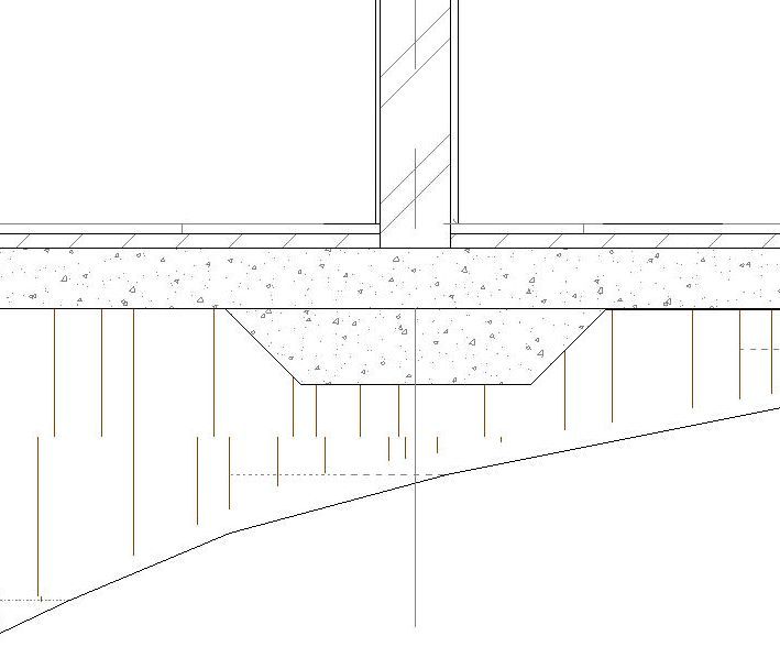

Hi all, how to create a trapezoid shaped floor-slab edge and or wall foundation based on the wall foundation family?
GrtzE
p.s. i tried it  to create a profile and make it a sweep at the end of the wall, but my wall is on top of the floor and the extra reinforced ribbon should be under the floor? so is it based on the wall or on the floor [the floor is continuing, so not an floor-edge?

You could probably do these thickened slabs as in place, sweep, floor families or you could modify a concrete beam family to this profile.

too bad, it isn.t possible by using structural foundations, but with an different shape,
just click the wall, and there it is,could the structural system family not be updated?

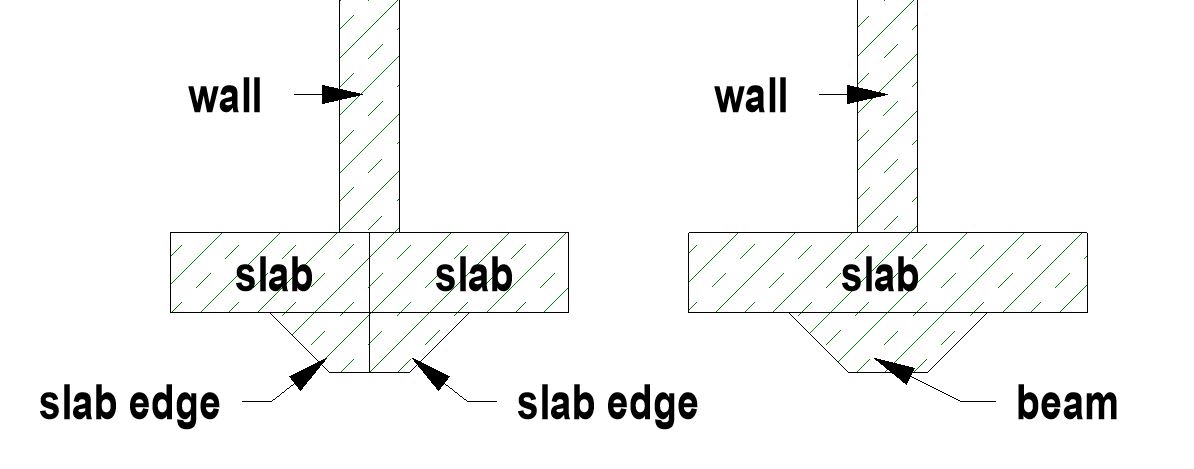

This problem have more solution, but i think the best are next 2: Using foundation beam with profil trapezoidal or use slab edge doing 2 slabs like in picture attached
