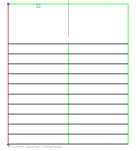

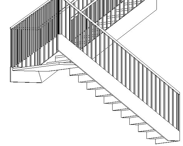

Untill now i always used monolitic stairs, no problem.But now i have to use a stair with stringer, and my stringers are sticking out like  scissors, i cannot make them go along the mid landing bottom.I enclose a picture

When you do stairs, their are two types of boundry lines that are created.  The stringers and the landings.   This looks like you pulled one of your stringer lines beyond your landing.

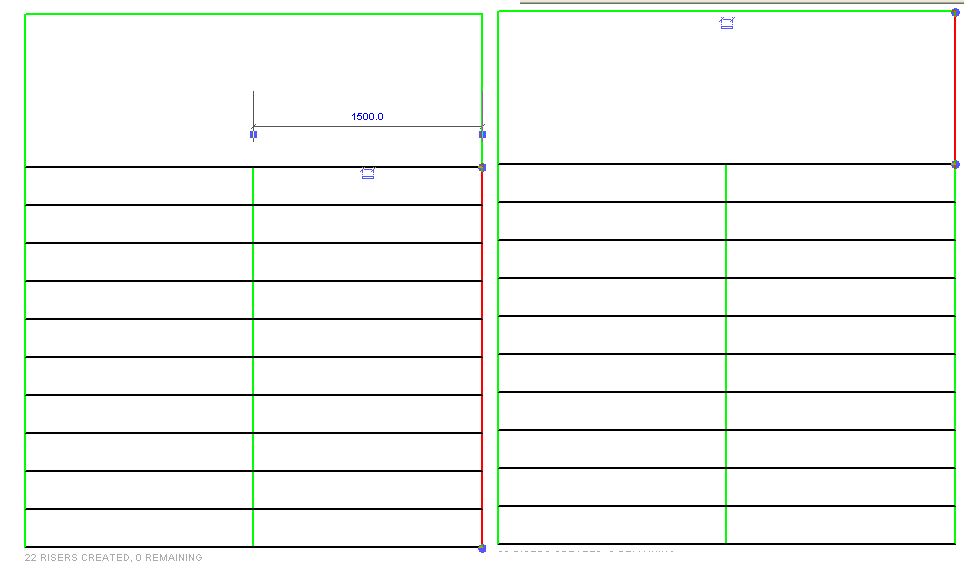

Make sure you split the boundary line at the landing. Have a boundary line for the sloping bit, and one for the landing. Refer to pictures as for what to do =)
