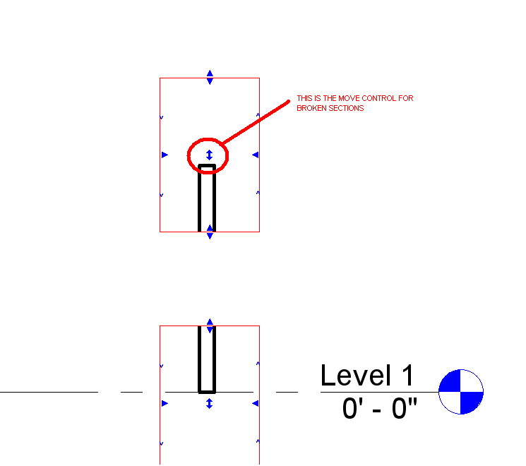

How does one, after inserting breaklines, bring the separated portions of an object together?

Once you have applied the Break modifier to the crop region there is a move control that appears in each individual region. Select the control and move move the region as desired. See attached image.
