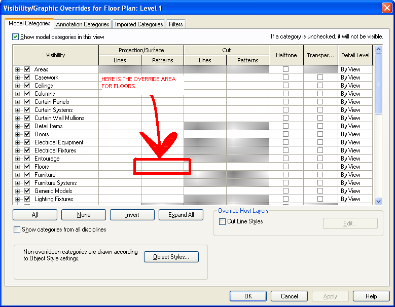

How do you turn off the floor pattern in Revit 2008? It's not listed in the visibility/graphcis over-rides menu any more...

Sure it is. Look in the VG box. There is a column for Surface Patterns. Click on the box and you will get the Override Button. This button will bring up a box and in there is a checkmark box labeled "Visible". Uncheck it.
Look at the attached image for the location of the Override.

That was it - thanks! Wasn't the floor pattern listed as a separate category in the past, along with slab edges and the like?

Quoting profbrody from 2008-02-28 10:18:29
"That was it - thanks! Wasn't the floor pattern listed as a separate category in the past, along with slab edges and the like?"
yes it was, this is new for RAC 2008
