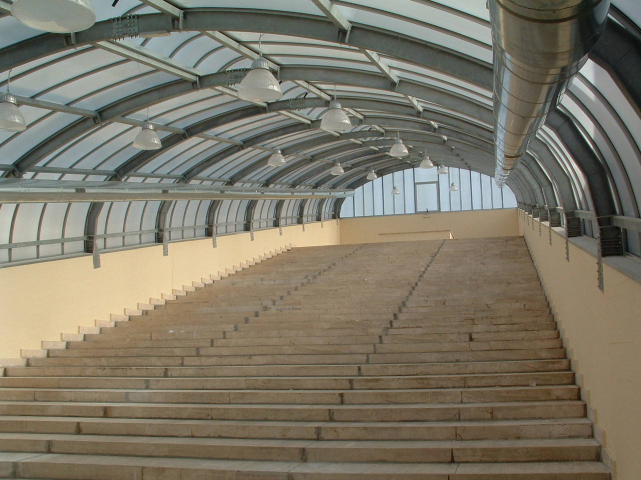

please help me ihave to make this sloping roofing but i can't do ! how i can do it with revit 7? please answer me its important

You can use the massing tool, create that shape as a mcurse with Revit 7 you can then choose to make the surfaces of that mcurseinto revit components (floors, roofs, curtain walls, etc.) I would pick the curved surface and make it into a curtain wall. Once that is done. Go back and change the grid spacing, and mullion types tp match the ones in the picture.

where is mcurse? it's easy to do?

CURVED SURFACES, THIS WEBSITE IS A LITTLE WIERD WITH SUBMITTALS
