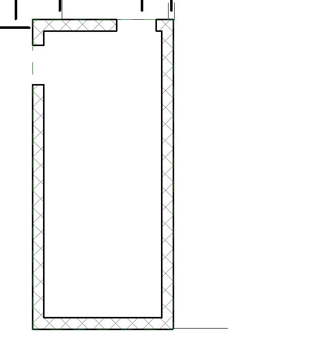

We are using Revit Structure 2008, just updated to the latest build on Feb 15. I am working on a demonstration for the owners of the company I work for.

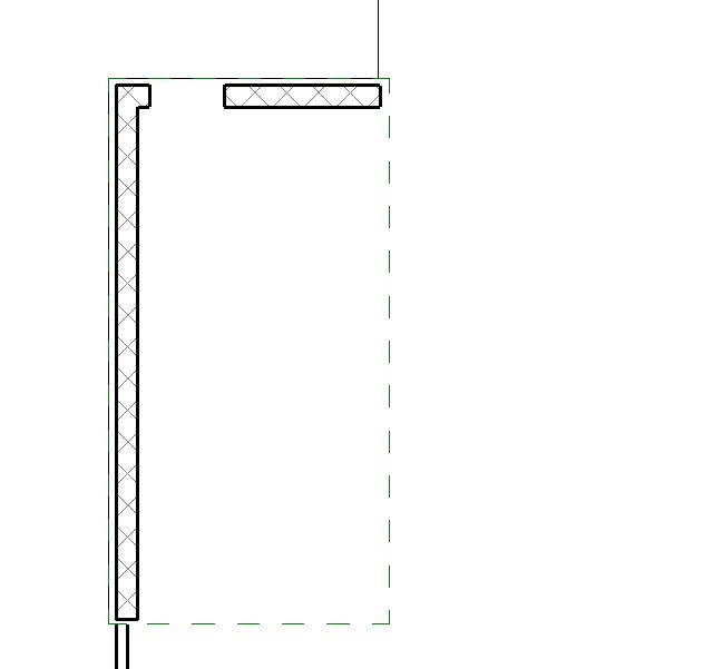

To accomplish this I have taken a project we have already done in AutoCAD and built the Revit model of the building. I am trying to make a second floor framing plan to compare to our plans done in AutoCAD. The building is five stories with three stairwells running from the first floor to the roof. In my second floor framing plan I want to show the masonry walls for the stairwells, but with openings on the first floor. I created a plan region around each stair well. On two of them the plan region seems to work perfectly, I get all four walls with the masonry hatch and the openings that are on the first floor. On the third stairwell I only get two of the walls showing. The other two walls do not show. All four walls are the same type, with all the same properties, offsets, floors, etc. All three plan regions have exactly the same view range.
I cannot figure out why all four walls do notshow up for this one stair well.
I have attached two JPG files. One showing a good region and one showing the problem region.
Thanks for any input.

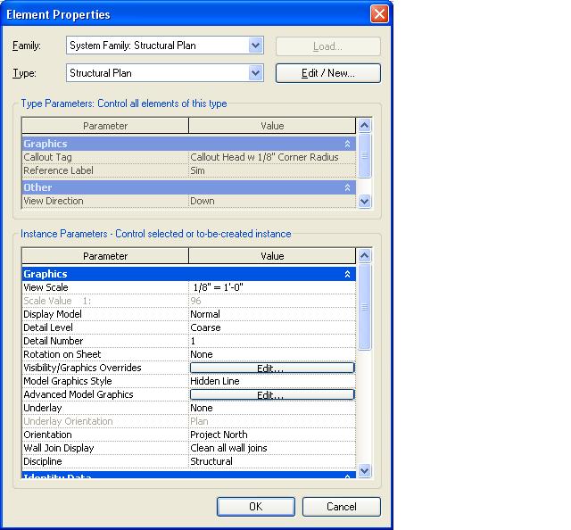

Are the walls set to structural? Typically non structural (non-bearing) walls do not show up on structural drawings. If you want them to show up you would have to change your discipline to coordination or change the structural usage of the wall to something besides for non-bearing. Or the walls could be set to a different phase?
If you still cant figure it out a screen capture of the element properties of both the view and one of the walls would be helpful.

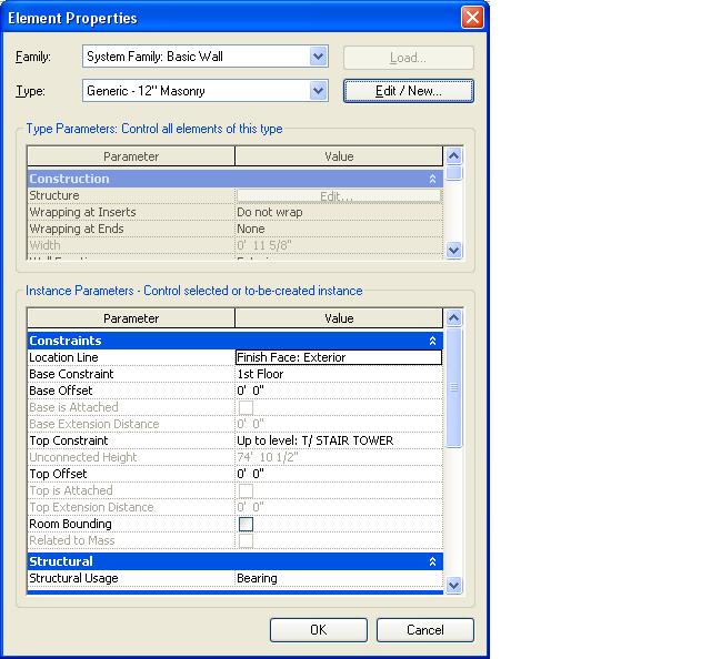

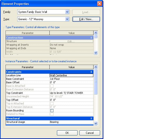

All four walls, the two that show and the two that don't, have the same properties, bearing and structural. The view is set to structrural. The really odd thing is that the three stair wells all have the same type walls, same properties, etc. Yet, this one stair well has two dissappearing walls. On top of that the only floor they do not show up on is the second. I don't have plan regions on any other floors, but all four walls show up correctly with all the correct attributes on all other floors.
I have attached the properties for the view, a good wall, and a problem wall. Hopefully something will stand out that I have overlooked.

Its hard to say given that the screen captures are not complete (the only way I know of doing it is by useing Snagit. Snagit will actually screen capture and allow you to scroll a window...)
The only other thing that I can think of would be to make sure that you didnt accidentally hide the wall in the view. Other than that you could try recreating the view and/ or the walls. Sometimes things get messed up and it takes longer to figure out why than it would to just redraw the walls.

With problems like this, 99.9 % of the time, I usually find in the end that there is a simple mistake made somewhere and it is not the program.  However, without a portion of the model at least to work with, we can't do much to error check this.
