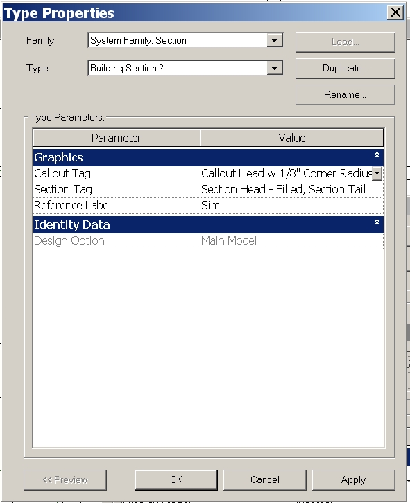

I want to modify the section heads annotation called "callout head 2 1/8" corner radius" see attaced.  Where is this found?  I searched the computer, found no such file.

Found it in imperial library.  You have to modify both the "annotaions\section-head Filled.rfa" and "annotaions\section-head Open.rfa".   I changed them to have opaque labels.
