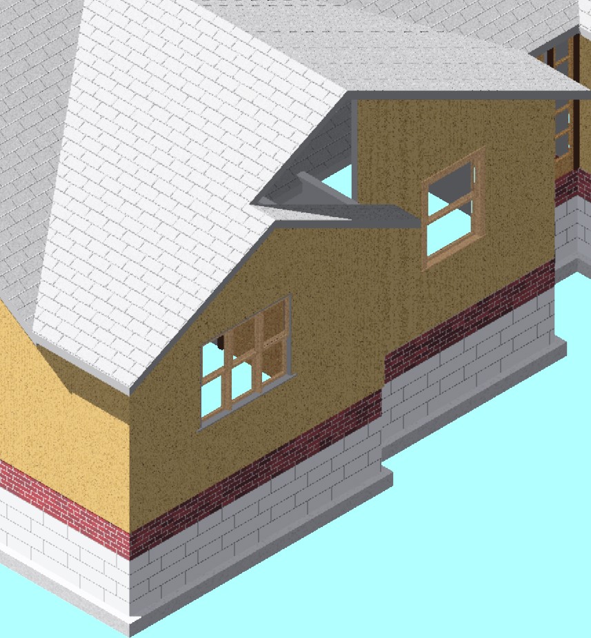

I am using Revit 2008. When I go to attach the top of the wall to the gable roof, I have a section of the wall that stops at the incorrect roof line. I need a wall to be in the section where it is missing (refer to image). How do I extend or create the wall to fill in the area where it is omitted. Again, I attached the other walls to the roof line.

This is a common issue. There are a number of ways to fix it. My first suggestion would be to use the Edit Profile tool and adjust the edge of the wall to fill in the gap. You can also create the roof as 2 seperate roofs and use Join Geometry. A third option would be to create another wall from the roof level and attach it to the roof.
