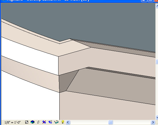

Im trying to put this sweep trim on the wall as shown. the profile changes angle as it turns the corner and goes down. this is undesirable.....how can i keep it flat to the wall?

are you sure you are picking the wall? it looks like you are picking something else, try to isolate the wall just to make sure...

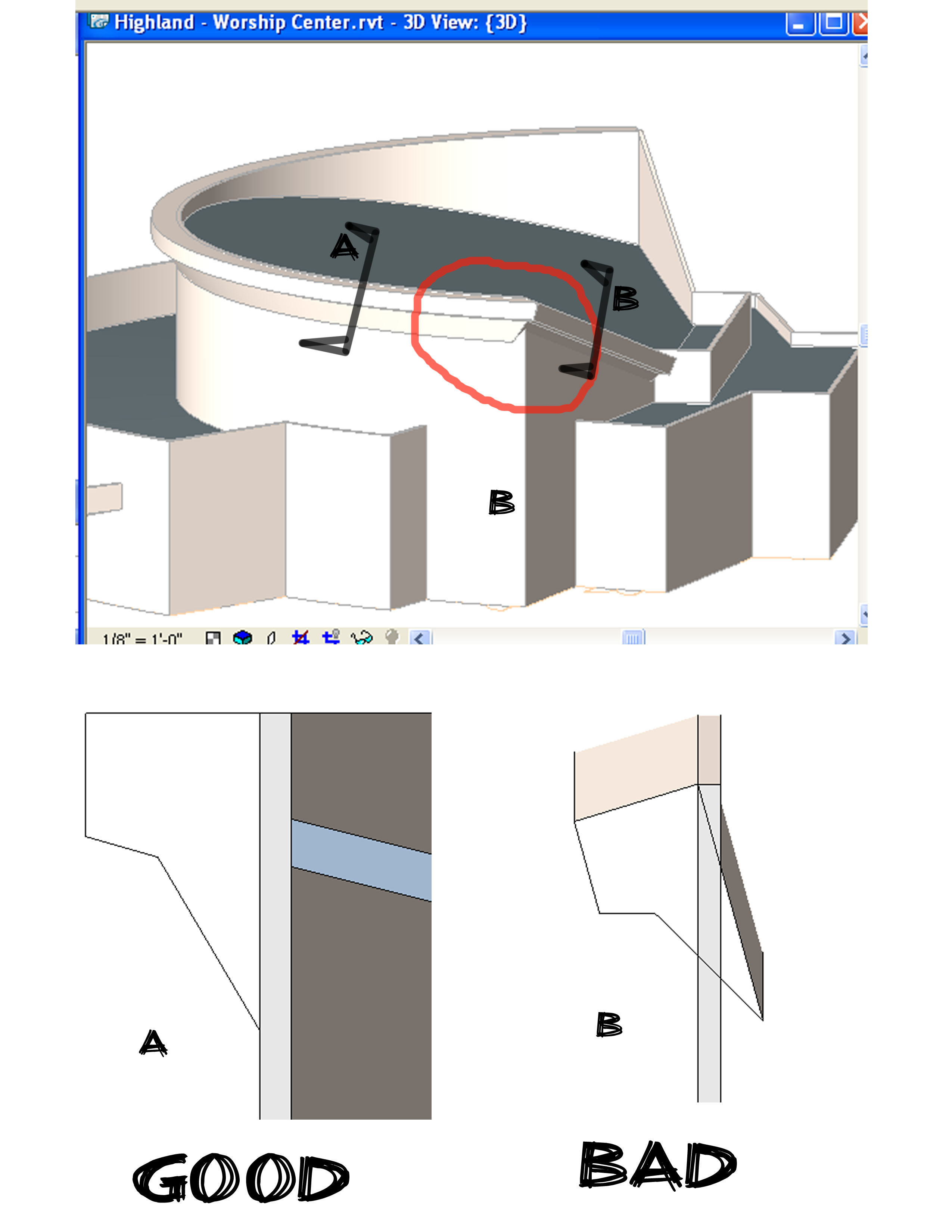

this is positively connected to the wall as shown at the bottom of the picture attached. section B. I wonder why its doing this and how a can make it work. my goal is to have that trim go all the way around the top of the building in the picture...

I fugured it out.....
FYI.....
I had to jog the sloped wall over alittle to allow for the thick sweep profile to fit and turn down.... see the pic...
