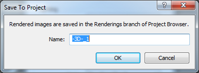

Here are the screenshots as reguested. I'm using an English version of 2014.
I just tried it again at Draft settings and your addin is saving the renders as it should. (Allthough the short filenames are appearing in the dialogs) Strange.

thanks, your help is very useful to find the problem.
can you please try if it works when you uncheck "save to project"? i think that this is the module that is causing problems.

thats fine! i would also need another screenshot when you ahve time please:
run the rendering without the plugin, when it is done, do not close the render window, select the render settings window with the mouse and press SHIFT + X.
after pressing shift + x a window should open (the same you posted a few posts ago..) please send me a screenshot of that situation.
But plaese do it by pressing SHIFT + X and not with the mouse.
thanks!
take your time!

When I hit Shift+X the save image dialog appears. (As it should I presume?)

yes thats fine.. is the textbox empty?

Not empty...see screenshot.

sorry my fault.. its SHIFT+V

It's not empty... See screenshot. Should it be?

Last night I retried to render 11 views. This morning only a part of the first view was rendered.
The region selection box was checked so only a small part of my view was rendered and the processbar showed 100%. The autoclose checkbox was not checked so it was waiting for me.
Can you fix this?
See screenshot

try changing the name of your views, the -3D- part is incorrect. You cannot save files in windows with a dash. Change it to 3D.
