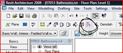

Also, I mispoke.  You can use the "edit CUT profile" command, not the edit profile command.  The edit cut profile allows you to manipulate individual component within the wall.  Sorry for my confusion.

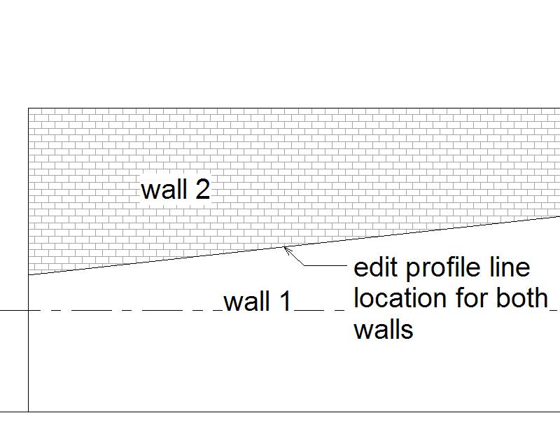

Look at the attached image.  I DO MEAN EDIT PROFILE !  One wall above the other and their profiles are edited along a common line.

"Edit Cut Profile"?
Where can I found that option? While editing the profile of the wall?

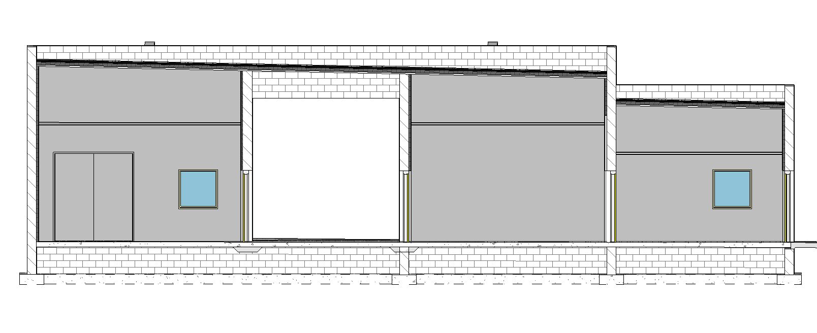

Rat69-the edit cut profile is used within the model, just as you would add a door, join a roof, etc.  My previous explanation still stands (the help info is good on this), but I attached a pic of the icon on the toolbar.
 By the way, the sketch I did did NOT use the edit cut profile.  I added the roof after I drew the walls, using lines and selecting the inside face of the CMU.  When I was done, I allowed the walls to attach to the roof (dialog box pops up asking if this is OK), and it automatically cut it as shown.  I noted in your sketch you did not have a roof drawn.  Just drawing that roof might solve all your problems.  (it looked like you only had bar joists-but I couldn;t quite tell).

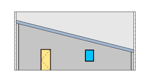

This is my current section (see attached). The grey area should be part of the CMU wall behind. Note the angle in the upper part of the interior face of the wall.
Right now they are 2 separate walls, but that is what I was trying to avoid. Is it possible to do this with the "edit cut profile"?

The edit cut profile would do this, but I am pretty sure you can do that without even needing the edit cut profile.  Try this:
1.  Delete the roof in the model.
2.  Add the components to the wall that you want on there.
3.  Add the roof back in, making sure you are below the top of the wall (you can always adjust it up in section later).
4.  When Revit asks you if you want the walls that are below it to attach, say yes.
Did it work?  If it didn't, post your file and I will take a look.

But if I do that the 3 elements of my wall will align with the roof (CMU + Insulation + Gypsum). I only want 2 of them to align with the bottom of the roof, and the CMU to continue like 2 feets above the roof.

When you add the roof back, use lines (not pick walls).  Draw the outline of the roof along the INSIDE FACE of the CMU (the line representing the inside of CMU and the outside of the first layer of insulation).  I attached my file that I had taken the view from.  You'll see that all the walls are stopped appropriately.  Also, the walls adjust when I adjust the pitch.

This is just what I wanted! You should copyright your idea Smile
There is a lot of people saying that was not possible with Revit (in this forum and in the Autodesk Discussion Groups)
