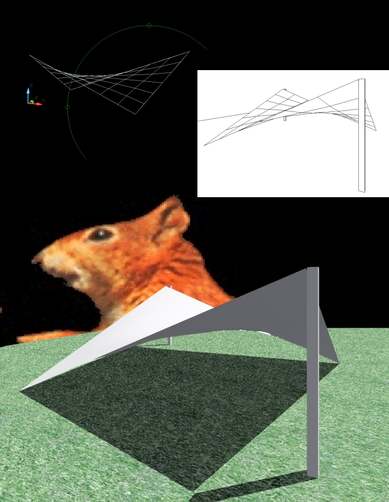

I made it in autocad It was no problem... First I made a point with a z-coordinate Command: POINT 0,0,2000 another POINT: 0,0,0 and then 3DPOLY between the two points and some rectangle on the groundlevel and copy the 3dpoly to the opposite side of the rectangle Then four 3DPOLY:s to construct the tensinets edges in 3D see the image. Then at the commandprompt EDGESURF and pick the four 3DPOLYS and the net is automatically constructed Save as .dwg Import it into Revit a camera view and then render - see the image OK! It functions for this simple structure but 3DStudio is much better if doing something little more compliated....

Here is the image showing the EDGESURF between four 3DPOLY:s as edges. And then the net in a cameraview in Revit And the rendering of the cameraview You cannot use long file-names on Revitcity??? That is why I have to upload the image once more!!!
