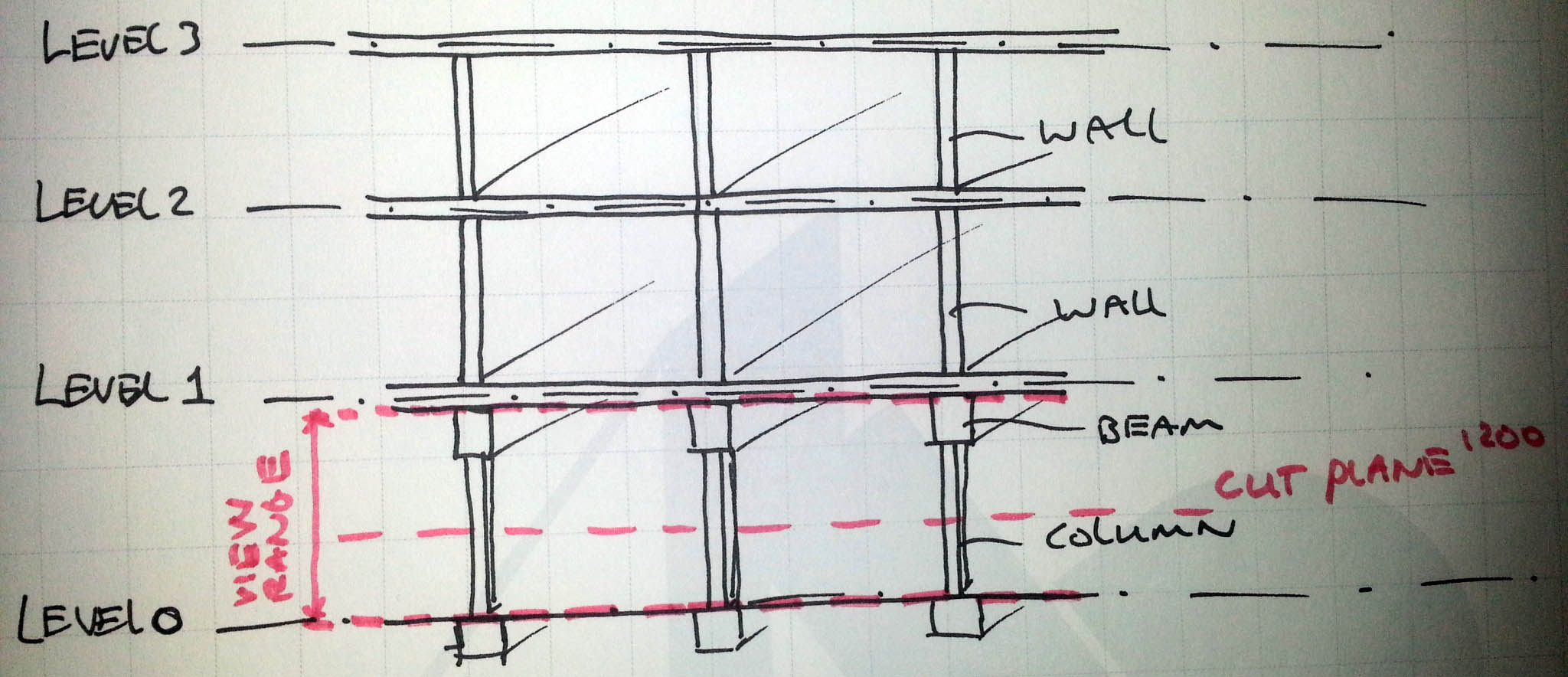

Look at the attached file. I did sketch my situation. Hope it helps.

Are you saying that while you are working on level 0, you want to see beams undernearth level 1, as in ceiling plan view?
If that's the case, you can place your cut plane at 3600, if the buttom of beams at 3500, top of beams at 4000.
Then change the structural framing line type to dashed and line color to red, for easy to read. This way you can work on level 0, at the same time see the beams. After you placed walls, change cut plane to 1200, then you can see all doors and windows.

Hi David,
Yes, that's what I mean. The link I earlier gave with the video was about how to achieve this permanently. The way you tell me is actually the same idea. I did temporarily change the cut plane to see the beams. After that I did change the linework, like you said. I did set the cut plane back to normal and voila! I can see the beams in my normal (coordination) view with all doors and windows available.I even never have to change cut plane again to 3600, because now with 1200 I still can see the beams and even move them SmileDoes everybody use this method because they encounter this problem? Or is it just me? That would be strange...
