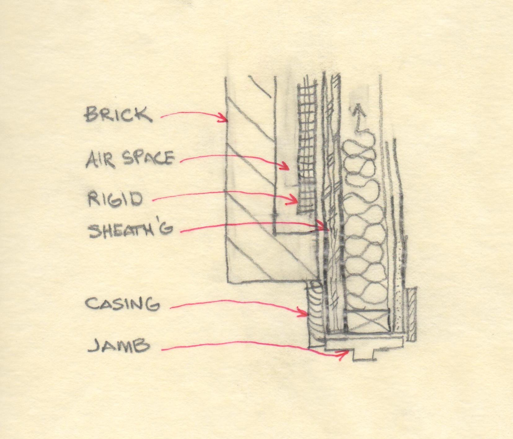

CDWdavid,
Thanks for the .rvt file, it will definitely help. The attached sketch is what I'm trying to reach.
I agree, in commercial/public sector, contractors will build (and charge to rip out and repair) exactly what you have drawn. I've been lucky with residential contractors.

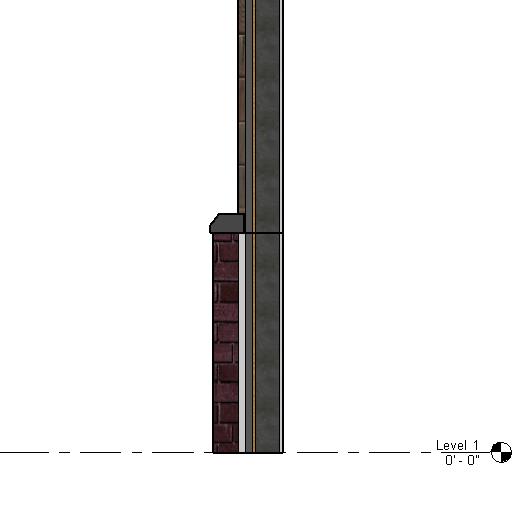

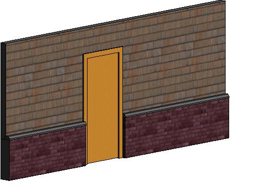

Fri, Feb 15, 2013 at 11:23:34 AM | Help with separated Door Jamb in Stacked Wall
#19
CDWdavid
Joined: Mon, Aug 4, 2008
153 Posts
5 Stars: 5 Votes
Hi Memmelle1,
Please see attached images, which should be closer to your intent.
Revit is a powerful tool, but to model a building to every detail yet still impractical.
The level of detail in attached images should be good enough for elevations, sections and building 3D renderings. Then using details, as the one in your sketch, convey your intent to contractors.
Followings are steps to get there, you might already knew some of them.
1.     Door/Frame family, the one in previous reply was a hollow metal one for school projects.
a.     It has four door panels, three with lights, controlled by “Y/N” and “Integer” parameters to show different panels on elevations. You can delete those and leave the flush one, and change the material to wood, or replace with a fancier panel.
b.     Door frame, you can change the jamb and header width from 2” to 3.5” for your casing; change the “Setback” to create the depth on 3D.
2.     Wall assembly, draw a stacked wall, pick it, right click, then select “Break Up” from the pop-up window. Now you can treat each section as a basic wall. You may insert rigid insulation as in your sketch through “Type Properties” under “Structure”; for “Default Wrapping” change to “Exterior” under “At Inserts”.
3.     Adding masonry cap, turn to elevation view, under “Wall Tool”, use “Wall Sweep” tool to add cap. I was using “Sill-Precast” one. Then change “Offset From Wall” and “Offset From Level” to fit your design.
Good Luck!
