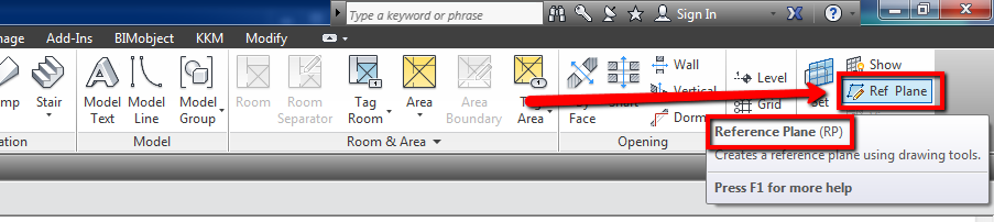

Right now my floor opening is the lenght of the stairs, 13'-9" for the floor and 13'-9" for the cieling.  In 3D view it seems like there is plenty of head clearance. I can see the door on the 1st floor. And the stair railing is 3 feet in height from the top of the 2nd floor.
Fri, Jan 25, 2013 at 11:28:04 AM | Question about stair openings
#17
Our code calls for the minimum clearance to be measured from the nose of a tread vertically - not parallel to the slope.  That clearance is to the complete structure - floor and ceiling so plan accordingly.
BTW, you can just add a vertcal RP in section that you can then edit your sketch to in plan.
Edited on: Fri, Jan 25, 2013 at 11:28:58 AM
Fri, Jan 25, 2013 at 2:49:44 PM | Question about stair openings
#18
revituser24
revituser24 Avatar
Joined: Thu, Jan 10, 2013
51 Posts
3 Stars: 1 Votes
what is a "RP"? and how do I "add a vertical RP in section"?
Sat, Jan 26, 2013 at 5:19:58 AM | Question about stair openings
#19
Joined: Tue, May 22, 2007
5921 Posts
4 Stars: 205 Votes
"RP" is "Reference Plane"
