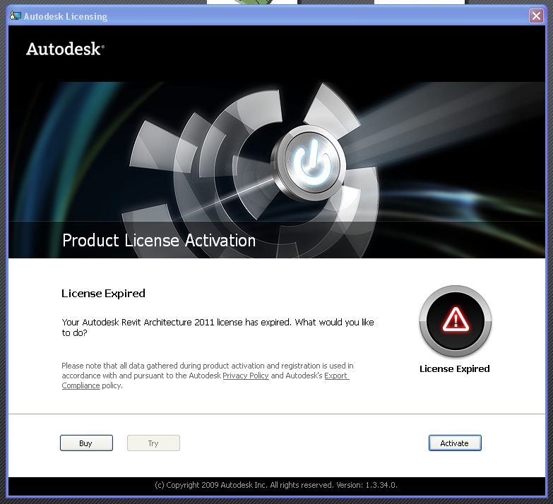

Ok! I understand the diffrence between the two. When I first installed this ( see pic) it worked fine for 30 days. Then after 30 days was up it went into demo mode (which allows you to use only, no printing, no custom family loading, and not saving) got that down! But what I'm saying for Arch. 2012 after the 30 days trial is up, and you try to run into demo mode the whole application just quits, But 2011 will still run in demo mode all day long.
So when the box window for 2012 comes up asking To BUY or Activate, the TRY button is grayed out, so when I hit the small RED X button to close window the whole application just closes out and nothing, but if I do the same for 2011 it goes into Demo mode just fine. So why does 2012 Arch. do this?? Thats the question!
