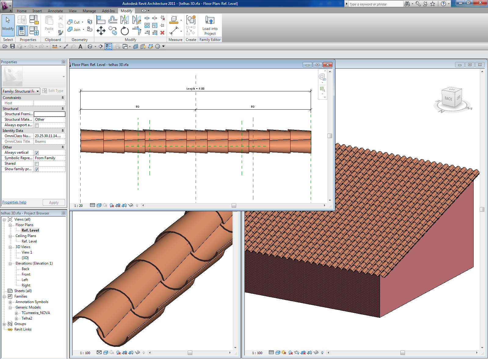

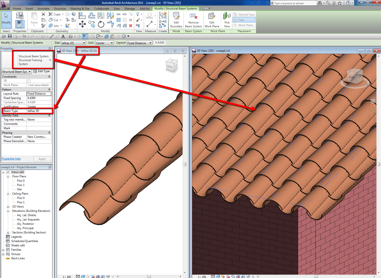

There is another way to create those Spanish tiles more realistic, using the "Beam System" and creating a new family "Structural Framing - Beams and Braces" like you can see in my images BUT this increases the file size, so, a good texture some times is better than this.
Watch this video: http://www.youtube.com/watch?v=JgCat_mzUwg
he don't show the process because he want to sell the DVD with the families and the videos where he explain that but this is the way he use "Beam system"
