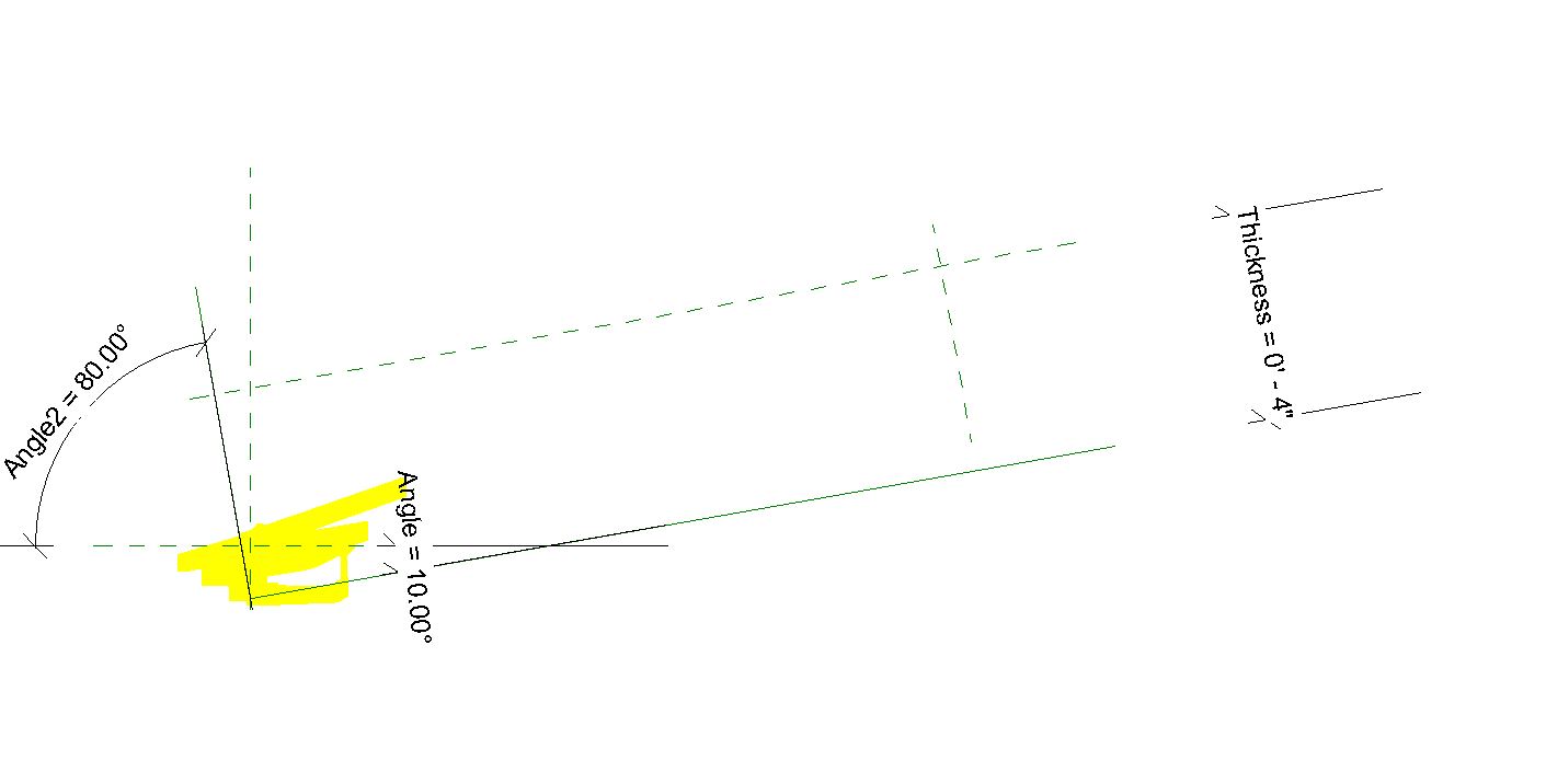

Despite the many responses, I'm not sure if the initial question was actually answered.  I'm having a similar dilemma where all I need to do is rotate a an extrusion to represent a very diagrammatic solar panel.  I can't believe how frustrating it is to do something that is so simple.  After creating the reference lines, pinning their ends to reference planes, setting the angle parameters, and then additional reference planes for the actual extrusion, I set the parameter between to reference planes to represent the thickness of the solar panel.  Then when I adjust the thickness parameter, instead of the reference plane moving up, the reference LINE moves DOWN and throws everything off.  I can't pin the reference line because then I can't use the angle parameter.  I can't believe how something that is so simple in other pieces of software is so stupidly difficult in Revit--all I want to do is rotate an extrusion.  THAT'S IT.

If I understand your post, your process is incorrect.  Download the "families Guide" from the autodesk site to learn how to correctly control rotation.  You do not use reference planes.

I do indeed use reference lines.  Look closely at the snippet and you will see the green lines denoting reference lines.  The ends of the reference lines are then aligned to the intersection of the reference planes to create a locked point about which they can rotate.  However, despite the fact that the end points of the reference lines are pinned to the intersection of the reference planes, the references lines still yield, even the the reference planes they are attached to are pinned.  It doesn't make any sense to me.

What/why are you pinning?  No need to do that...
...or are you flexing the location of the reference plane location and expecting revit to follow that?
