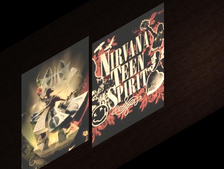

sorry i just read all ur posts right now ..u mentioned the  decal settigs givin u black n white images that are too bright i guess thats because your settings aint perfect...i too had to do alot of custom setings to get my job done..m attachin an image just see if it is  kinda sumthin u need.. plz note i havent used high quality images
Mon, Apr 19, 2010 at 9:01:41 PM | Using photos on panels of curtain wall?
#22
kyle4552
Joined: Tue, Jan 26, 2010
14 Posts
yes that is pretty much exactly the appearance i was going for. mind if i ask what custom settings you used or at least what stuff you changed?

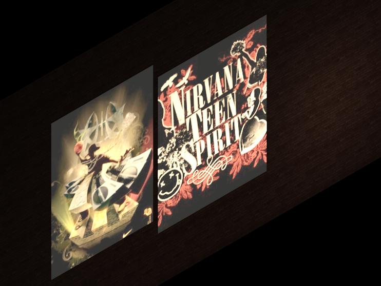

just a bit more playin  with the  decal can work wonders for you .....just increased the intensity of the images in decal to get this new render ..plz compare the previous attachment wid it
  u wud be able to make out  the difference pretty clearly..... i believe you have to have different settings for different decal images....sounds a bit hectic  but thats the way it goes
Mon, Apr 19, 2010 at 9:04:53 PM | Using photos on panels of curtain wall?
#24
Arafat
Arafat Avatar
Joined: Sun, Sep 20, 2009
6 Posts
3.5 Stars: 4 Votes
"Luminance(cd/m^2)" custom setting was set to 5
" intensity "was set to 75...
but as i have mentioned earlier it all depends on the image u choose
