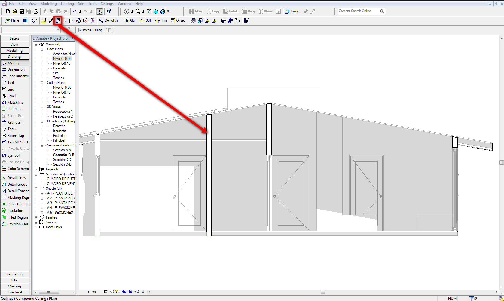

see this posting http://www.revitcity.com/forums.php?action=viewthread&thread_id=15584.  i can't get my interior elevation profile lines to follow the room geometry.  i need to research this more before i know what to ask.

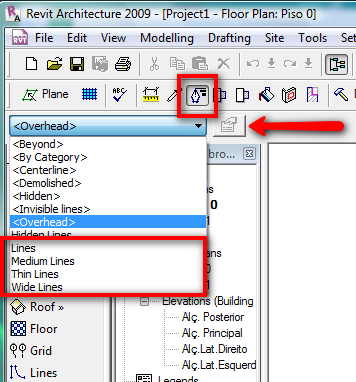

Try "Linework" tool...

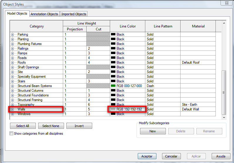

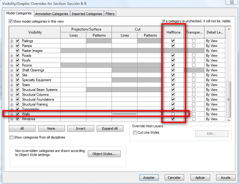

Hi jprado, you can try this: in Visibility/Graphics Override, in Halftone, check all the categories except the walls, then go to Object Styles and change the color of the walls to grey and as Typhoon says, use the Linework tool, .....

Thank you.  The linework tool was the thing i was missing.  You guys are the best.
