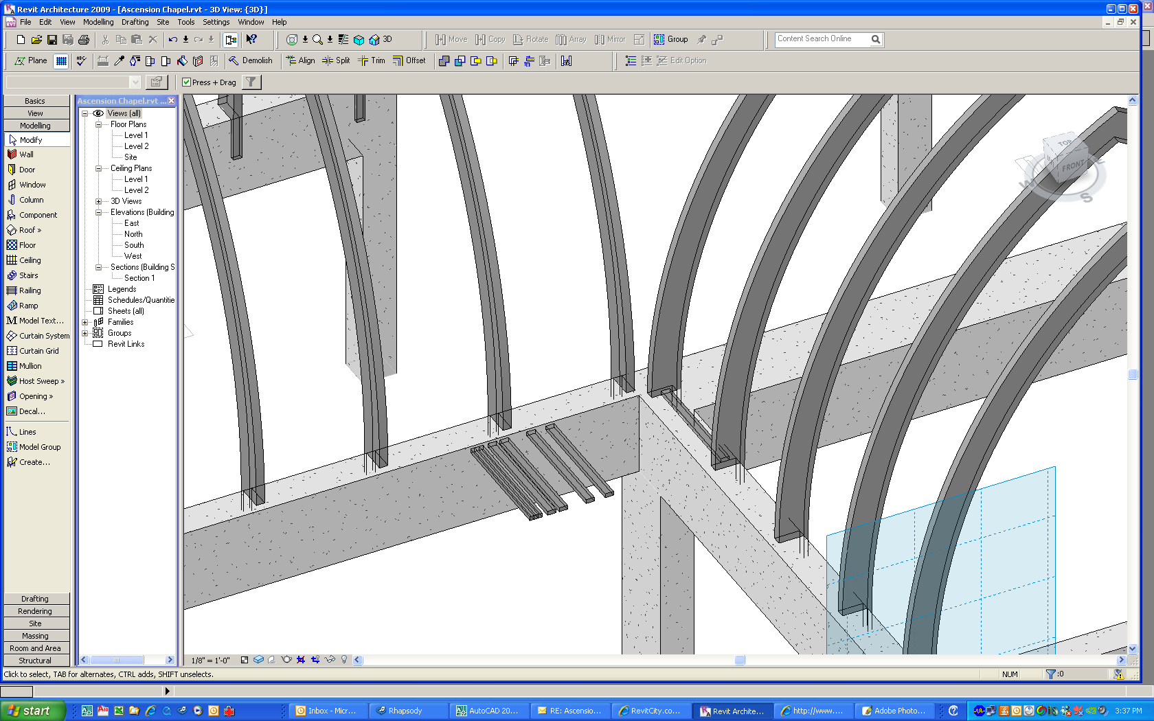

I may have spoken too soon.  I just made a 'face based' generic model purlin, and it attached to the glulam just fine, but when I tried to array it i get the following:

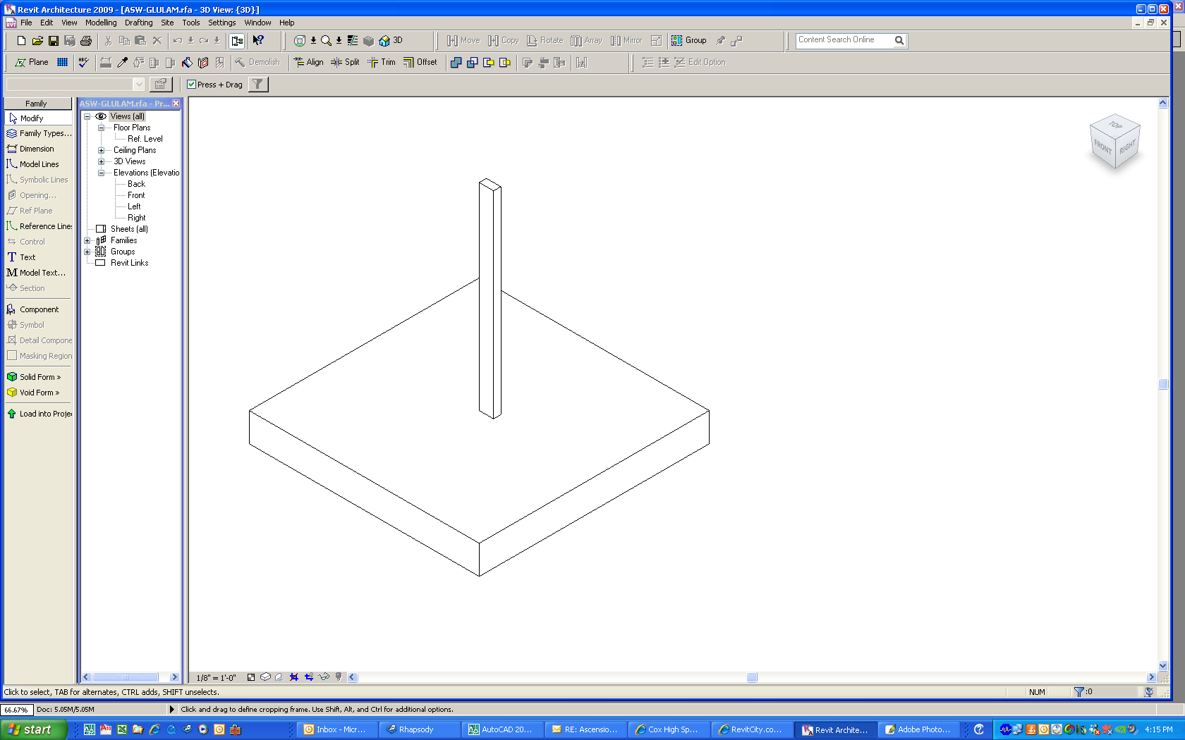

greg1970
Joined: Fri, Oct 24, 2008
49 Posts
I think I did exactly as you show (I wached the video too and  seem to be doing the same thing)
first image shows my face based purlin, second image shows that one purline arrays ok, but rest array in horizontal plane:
