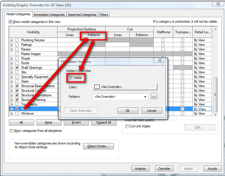

Quoting WWHub from 2009-04-10 12:19:51
"Also - makes sure surface patterns are on in VG. "
One of the first things I looked for was a toggle for this in visibility/graphics because that's typically the solution, but I don't see anything for surface pattern in VG...
Fri, Apr 10, 2009 at 12:37:37 PM | Missing surface patterns in 3D
#17
I asked if you looked at VG .. you must not have.  The surface patterns of walls is set to hidden.  Turn them to visible ... done!
Fri, Apr 10, 2009 at 12:42:32 PM | Missing surface patterns in 3D
#18
Joined: Tue, May 22, 2007
5921 Posts
4 Stars: 205 Votes
Yeah.... it's hidden in VG..... WWhub was right at the first time...
