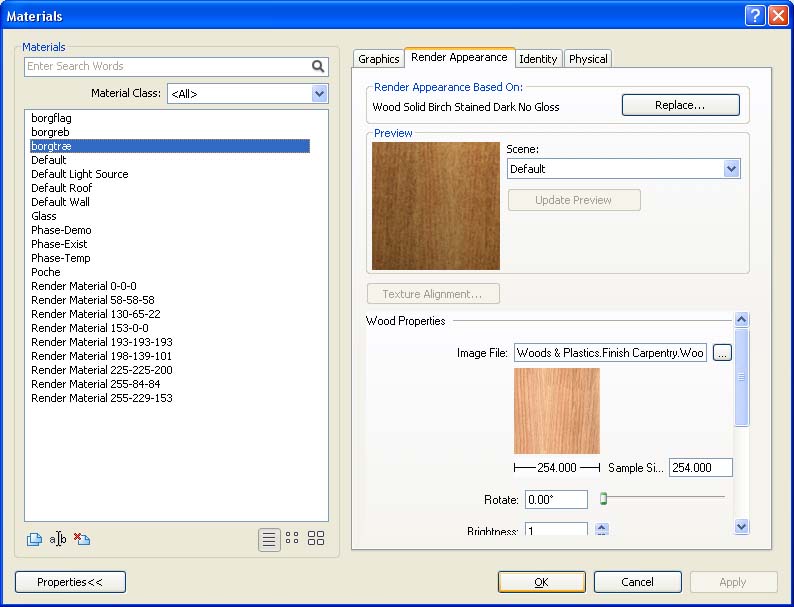

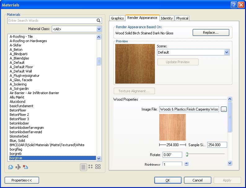

If it renders the default grey then that's because you have not assigned it a material.  Post a screen shot of the material assignments in the family and then one of the project.  In the project it should be under settings materials.  Have the material picked in the left column and the render appearance tab selected in the right column.
Mon, Jul 20, 2009 at 9:59:39 AM | Apply Revit materials to Sketchup import
#17
arkoh
Joined: Thu, Sep 20, 2007
28 Posts
They are identical... I've attached them, just in case there is something I simply cannot see! ;-)

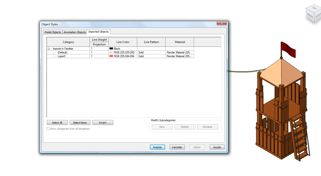

Mon, Jul 20, 2009 at 10:54:39 AM | Apply Revit materials to Sketchup import
#19
erland73
erland73 Avatar
Joined: Fri, Sep 7, 2007
738 Posts
4.5 Stars: 85 Votes
In addition, I always recommend to change those names i.e. "Render Material 200-200-200" to "XYZ" this for a  better identification of these materials in your project and because of what WWHub told you before about that the project over-rides the material assignment in the family....

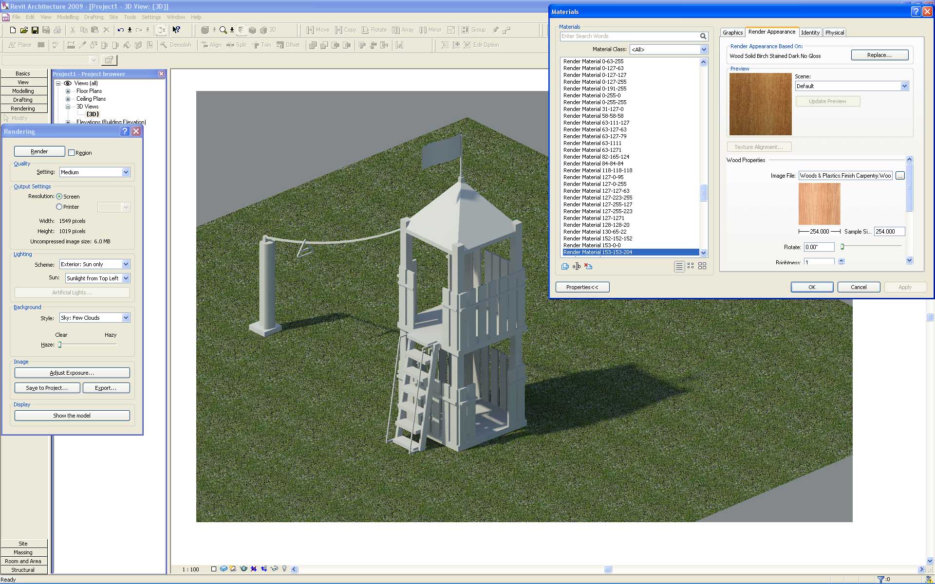

arkoh
28 Posts
@ typhoon & erland73
First of all, just wanted to say that I REALLY appreciate you guys trying to help me out here!!!
Tried to go back to the beginning... and did it all as simple and as straight forward as I could, from your advice there Typhoon!... Imported my SketchUp model to a new family, went to Settings/Objert Styles/ and instead of making new materials and assigning those, I located the different RENDER xxx.xxx.xxx materials allready assigned to the different layers from SketchUp, and simply changed them to the material I wanted. As I see it, I am doing excatly what you suggest Typhoon... right? Then I imported this new family into a clean model, made a toposurface and placed my little kids castle there on the ground... checked that the RENDER xxx.xxx.xxx materials from the Family, were there in the material settings, and checked that the materials I assigned were really assigned... and so they were!... and then I did a small testrender...
And SAME curse HAPPENED AGAIN!!! :-/ (See attached bitmap)
What am I doing wrong here???

erland73
erland73 Avatar
738 Posts
4.5 Stars: 85 Votes
"...Imported my SketchUp model to a new family, went to Settings/Objert Styles/ and instead of making new materials and assigning those"... Compare the first image with the second one, that's why I prefer to change the materials in Settings--> Materials.... you can see that there are more materials available and what I did is just to change the names...
