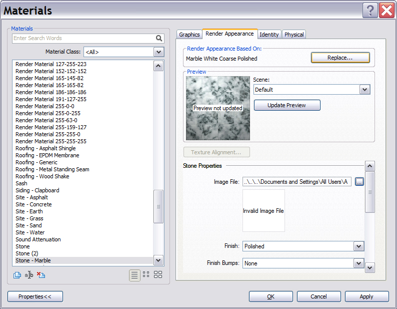

i have been trying to create a new marble material using the older JPGs from accurender and when i repath to the new image file i get a message that says 'invalid image file' and the preview goes black. any ideas why this is happening? ive tried moving the jpg to the assetlibrary location in program files with the other JPGs that come with 2009, but still no luck. thanks

Fri, Aug 8, 2008 at 4:35:07 PM | Adding New Materials to the Render Appearance Library in RAC 2009?
#24
colin1182
Joined: Sat, Jun 14, 2008
17 Posts
4.5 Stars: 6 Votes
i have attached a screen shot showing the 'invalid image file' error i get when i browse to the new image for the material. still no luck with any of this....

Yeah, Colin, hi post right now in other post but if you see your image then "Invalid Image file" its because the path before that are invalid, if you pick in the right of the path <...> you open the the folder when you can search the image (texture) you want....

yes, that is exactly what I am doing. I click <...> to browse, locate my image on my harddrive, select it and click 'open' and then instead of displaying the image, it dispalys 'invalid image file' like in the thumbnail i posted above. The file i am choosing is in .JPG format like all the other images used for render materials. I have also tried simply changing the JPG to one that came with revit 2009 just as an experiment and still get the same error message in the window.

I think I got it....I opened the JPG in photoshop and resaved it as a PNG file type and when I loaded the image in the material editor it appeared totally normally. What I don't understand is why the rest of the materials work in JPG format, but that besides the point. After the file conversion it seems to work fine. On the subject of textures....anyone have any idea if there is a location to find or download these images for rendering purposes? Id like to build up a large material library and transfer the project standards into the revit file template so that each new project I Start will have all the new materials built into it already.

the problem, i have discovered, is localized on my computer only. i tried changing the JPG on a different computer in the office and it worked fine. something about my network settings isn't allowing the files to be repathed correctly. ill have to wait until monday when the IT guy can take a look. thanks for all the help though....
