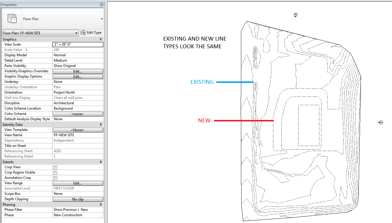

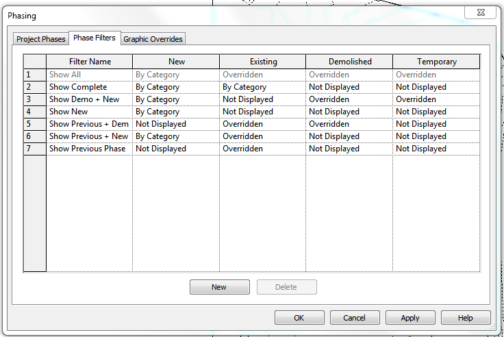

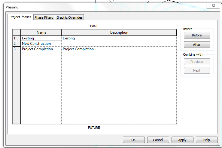

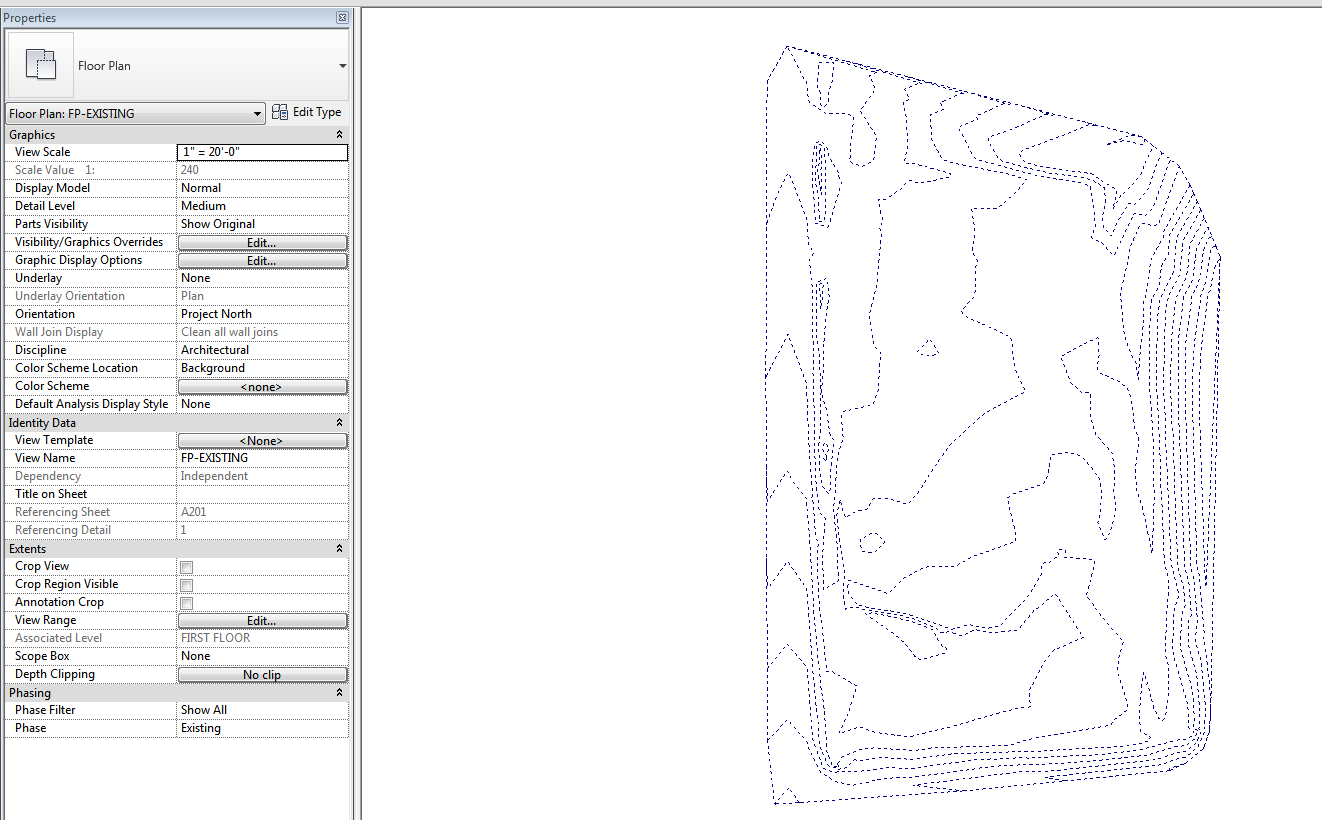

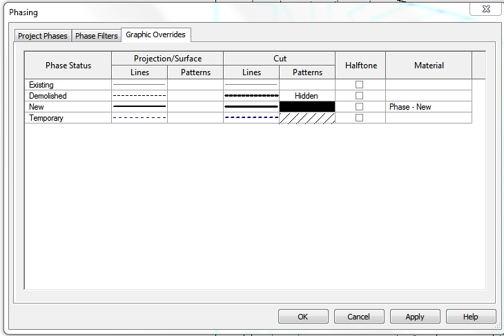

WWHub, I am using phases.  See my attached images.  On one plan I have my existing with my existing phases set up (works great) on the other is my new plan which shows the existing grades (minus the demo'd grades) and the new grades but BOTH show up as dashed lines. I don't know how to differentiate the existing from the new on the same plan

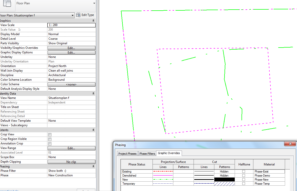

If you don't have full control over your graphic overrides with Phases, perhaps some other override is stronger. I resently tested the differnt overrides and came up with this:
Graphic overrides to Object style:
Weakest override is By Catagory
Then By Phase
Then By Filter
Strongest is By Element
Hope it helps, Sofus
