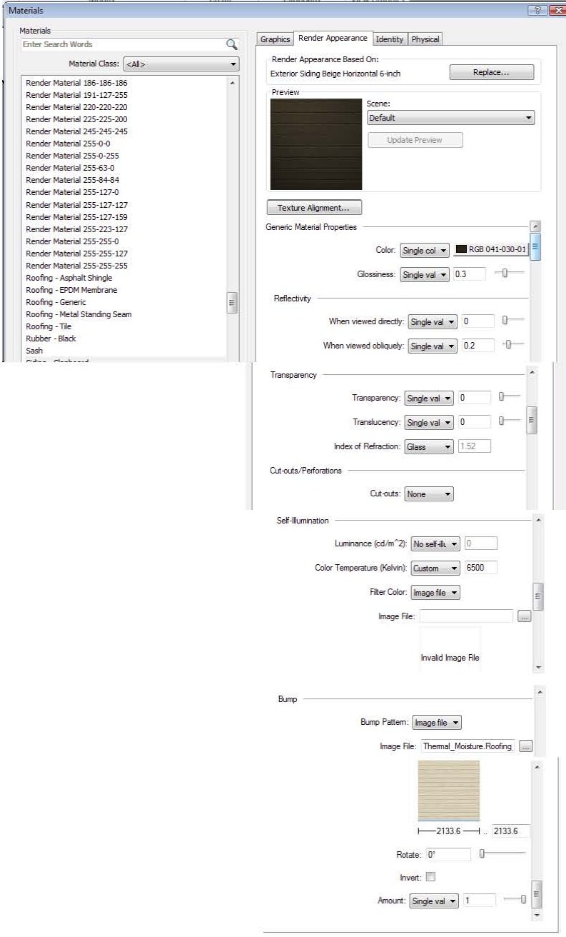

i have never changed any of the bump settings, not sure what they do. Here is a view of my screens and an image of my rendering is earlier in the thread ...

the bump is what gives your materials it's texture.
It's an alpha file that creates depth on the dark shades of it, so a brick bump has black mortar joints and white bricks with black dots on it, so it knows the mortar is deeper then the brick and the dots are surface impurities
So the material shows should have black horiztontal slits but otherwise fairly plain texture, does it render with the slits ? if so then your rendering is fine

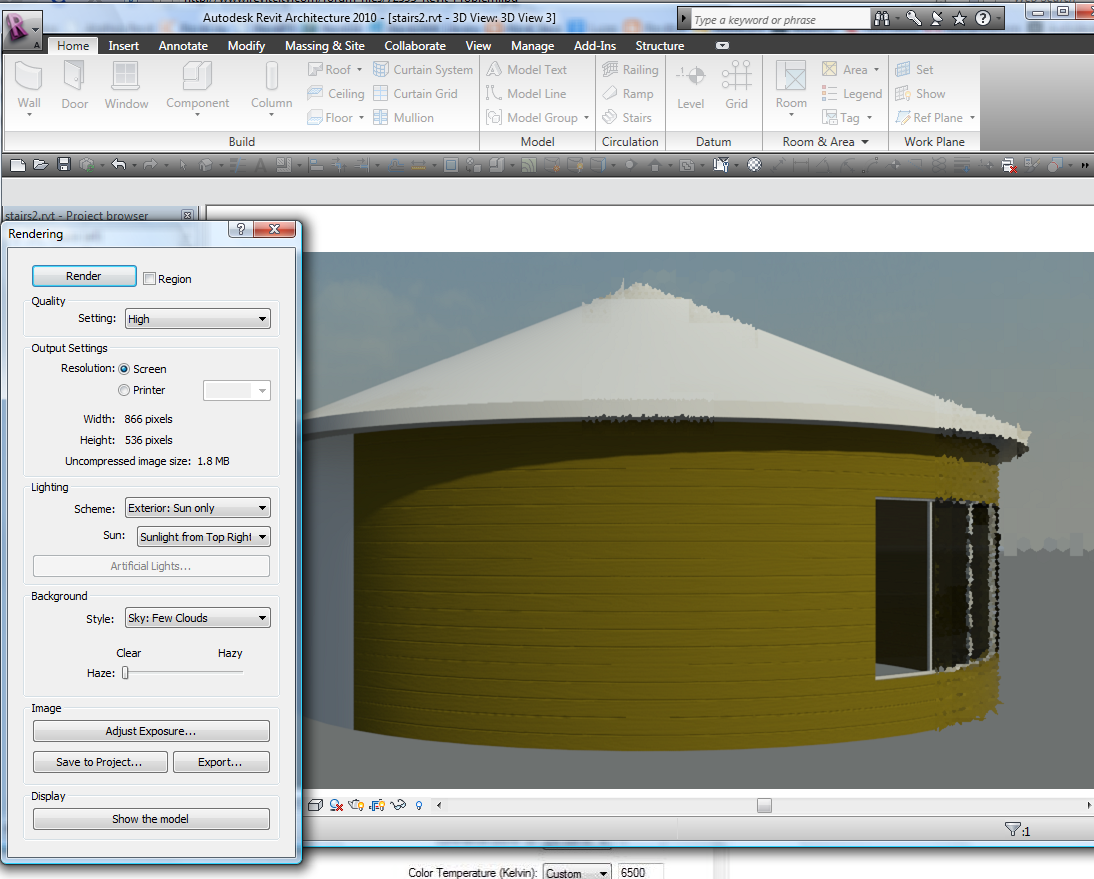

No. Even close up it renders completely smooth.

I suggest moving the bump file to your desktop.  re-assign it in your properties so you know the link is true.  then to a reigon render, if it works then you know it'll be a path problem.  If it still doesn't work you might need to reinstall revit as it'll be an issue with your render engine as apposed to your materials because your material properties are spot on

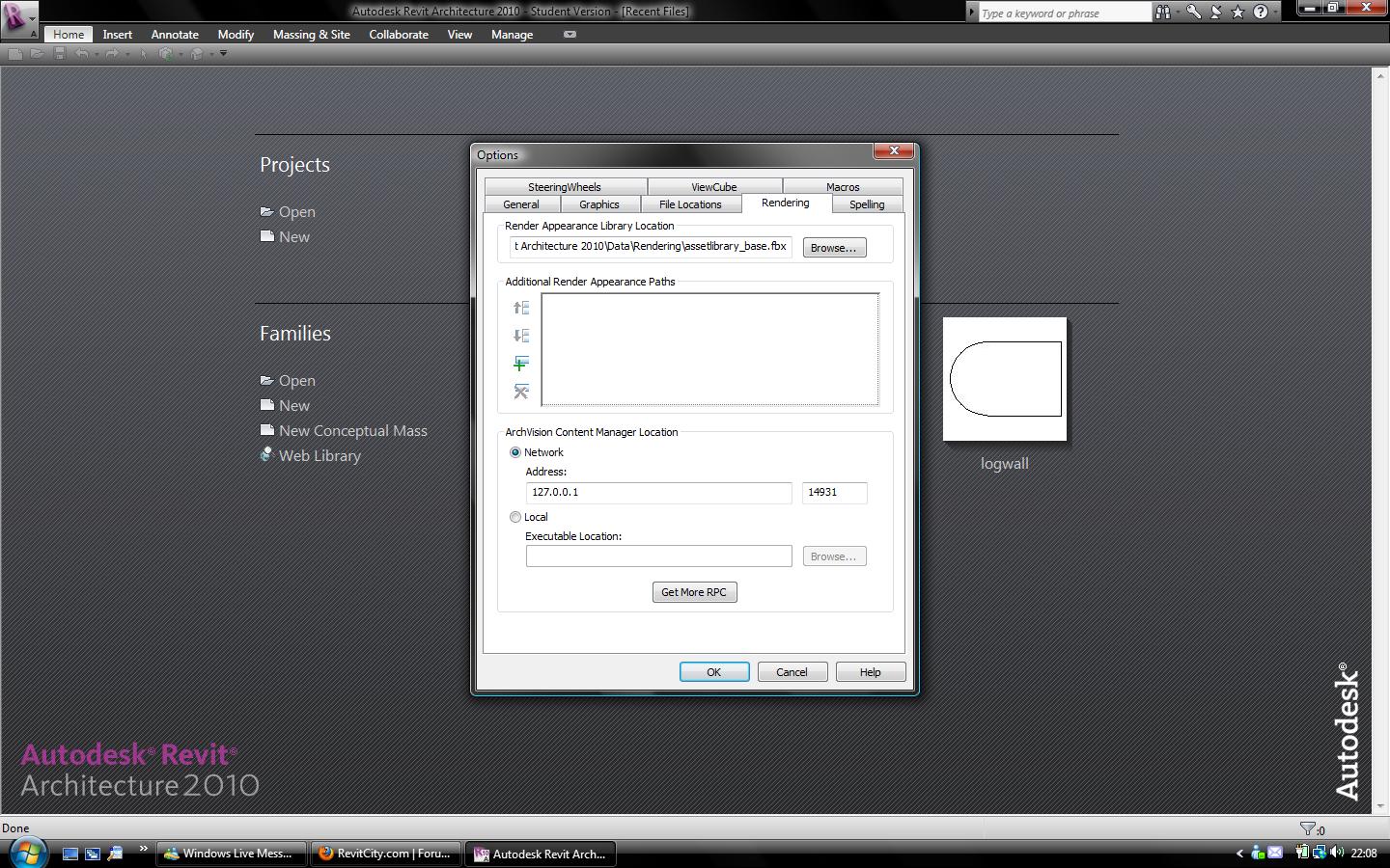

also check you have the material library pathed up
can be checked in the options menu as imagedand/or duplicate it and assign it as a backup addition one off of your network
