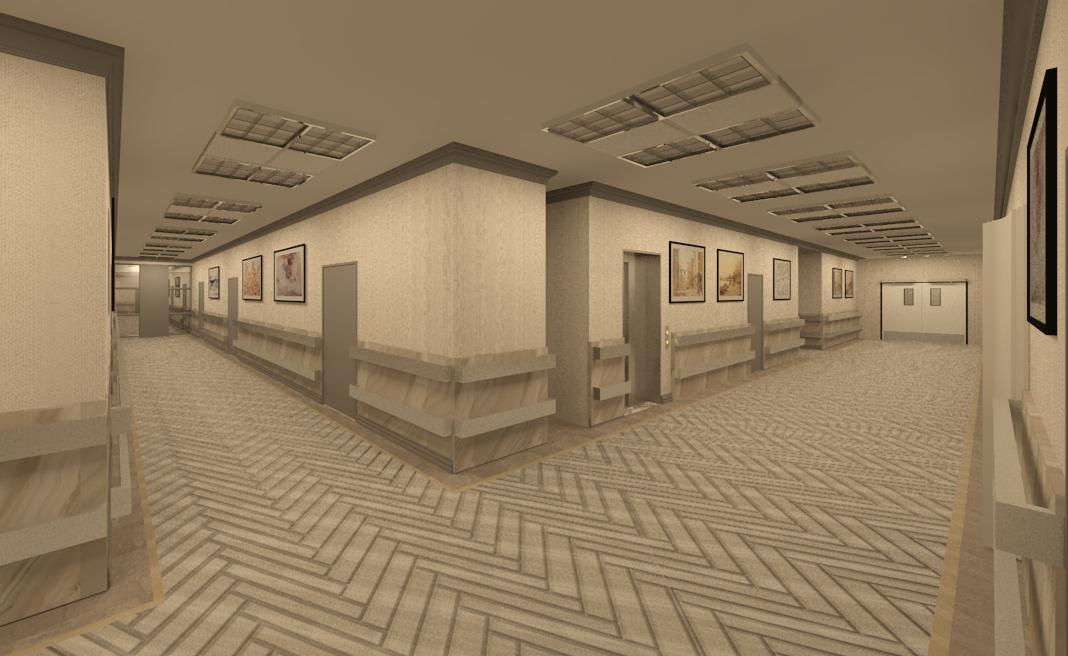

I'm trying to give my tile a texture look. I did this by creating a bump pattern in autocad and then layering on top of my floor.  The bump lines look so thick and heavy.  What am I doing wrong?
Attached is a picture of the floor tiles.

What is the correct way to set up this floor for rendering?  I would like to be able to see the herringbone pattern on my floor.  Without the bump that I stuck in there, all I see is a gray smooth floor. I can create the model hatch pattern, but there are no grout lines when I render.  I don't know how to define the shape of my tiles in realistic view when using the herringbone pattern.

Sorry.  That's what you are looking at in that picture.  It's a custom relief pattern.  But the lines are so heavy.  How do I make them thin?

Okay…If I wanted line work to appear “not so thick”, I’d probably look at the image’s scale first – not with the Bump or Relief. Those are by-product images.

the grout lines are huge relative to the size of the tile.  I think this might be causing some of the problem.
