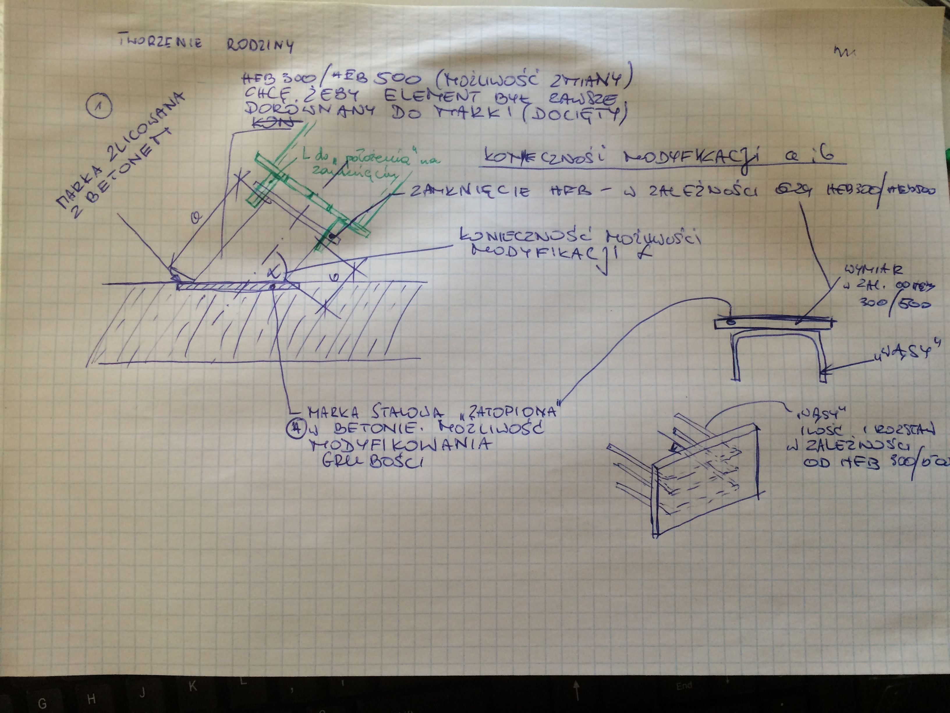

Hello to everyone, as it is my first topic here, on RevitCity. My problem is as following:
I would like to create a family, which makes possible for me create an element which you can see in attached image coloured in blue in any desired place in reinforcement wall. Element consists of HEB 300 or HEB 500 cutten as "sasuage" with ending plate and a plate placed in concrete with bars (in Polish: "wąsy") providing anchorage. It's important for me showing HEB cutted exactly like I want - in "sausage" way, and I am not interested in HEB which isn't connected directly to place based in concrete graphically as Revit provide normally. I want to have a possibility of changing HEB angle and it's ending in that way that HEB should always be cutted face-to-face with plate placed in concrete. Plate placed in concrete will be nested face-to-face with concrete itself, and then I would like to put it 20-50mm under the top level of concrete, but that I will probably manage to do with the help of elevation/view (I can't find any other solution, but if you know it, please be my guest! Smile) In the picture you can also find a green part - it is next element, consisting of wide pipe, it's closure as plate and welded to it two angles. Those two angles will be next placed at the top of ending plate of HEB300/HEB500. Is it possible to put them directly in that place?
Please see also attached sketch.

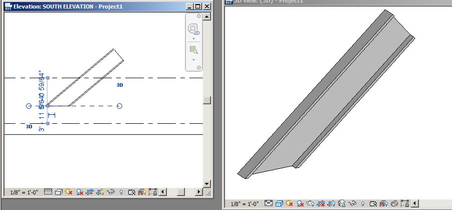

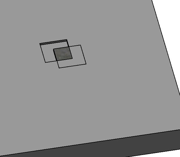

Attached is a beginning of a family.   I used the generic - faced based template.  As you can see from my image, I only have a plate and a void.  I create the void off to the side and set it to cut the host.   You can also just create the void first in the right place.   If you don't do either of the above, the void may also cut your solid.  As you can see from the image, the plate will not show correctly if you don't cut the host.
Play with this family looking at the void and solid properties.   I suggest you start with reference planes to control the dimensions - I did not.  Learn...........

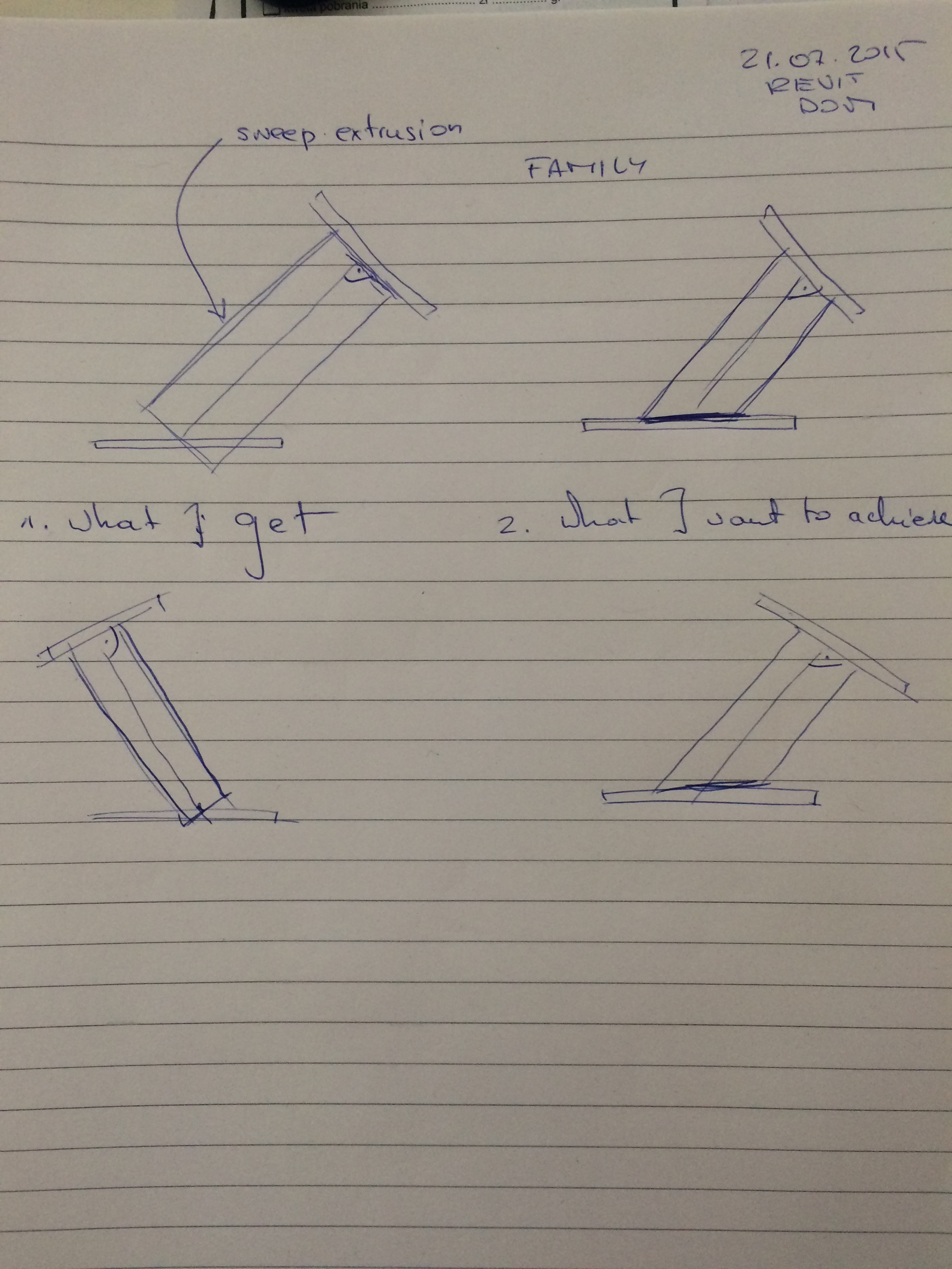

However, I still have a problem with that task, and this time I hope that you will be able to help more directly. Please see attached file.
The problem is to cut I-section in that manner that it will be all the time in one line with plate based in concrete.

Use a reference plane and the CUT - pick beam then reference plane.

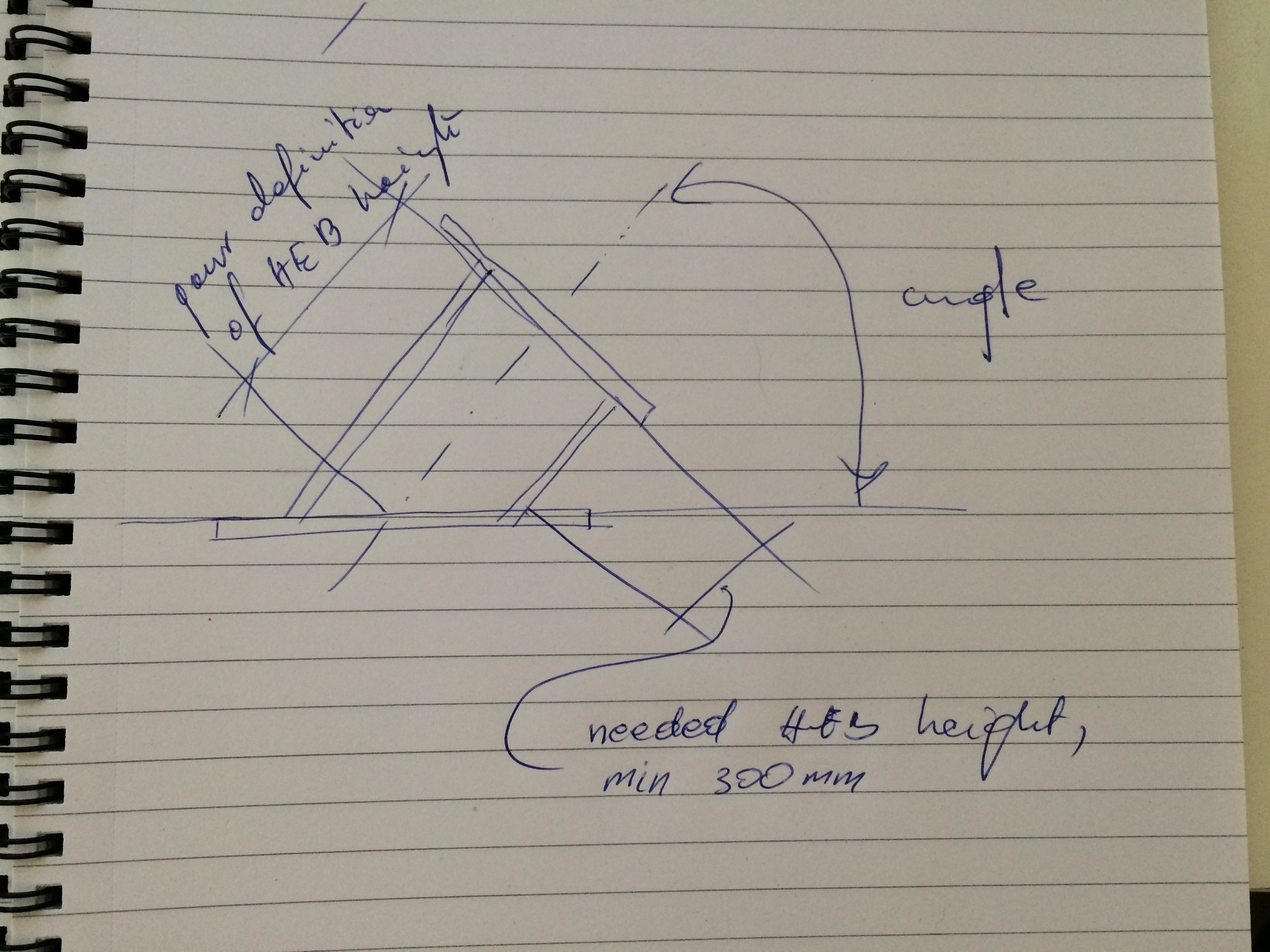

I am in the middle of decoding parts of family, namely HEB2, which I have already changed into HEB300, however I have first question connected with that, please see attached image.
You are measuring distance between start and end of the centerline of the HEB, and for the construction purposes I would rather need exact 300mm for the smaller part of the HEB300, as shown in attachment.
Moreover what do you think about ending plate - should it be also connected to that family or rather should be use as another family?

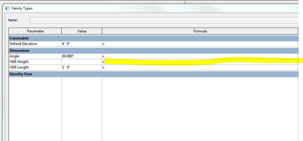

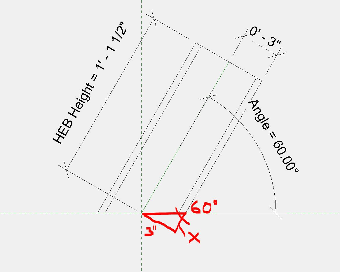

In the HEB family, you need to use some trig and formula to get that length. Create a new parameter, let’s say ‘HEB Length’ (no dim necessary) – it will be your input value, which will drive the ‘HEB Height’ parameter. Get the X value (pic 1) and subtract it from the ‘HEB Height’, or add depending on the angle. The formula (in the HEB Height’s formula field, pic 2) will have to be nested conditional statement, something like this:
if the angle is 90 deg, then use HEB Length, or
if the angle is less than 90 deg, then add X to HEB Length, or
if the angle is more than 90 deg, then subtract X from HEB Length
I’m not sure if RevitCity has any sticky on formula syntax, but you can find some here or search the web. At first it might look scary, but it’s really not - just some trigs, that’s all …and it’s a great exercise, you will learn something.
