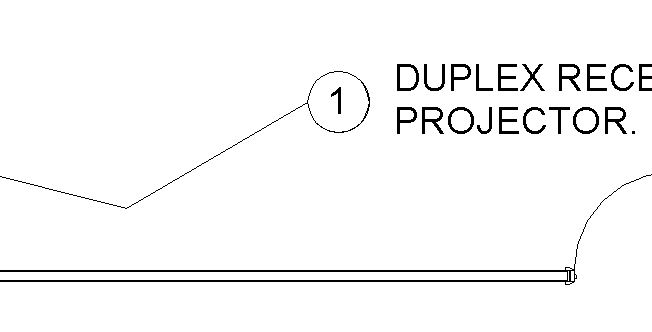

Is there any way to eliminate the space between a coded note and it's leader line?  My boss started marking it up to make sure the leader line touches the coded note and I cannot figure it out.  Thanks!

Wed, Feb 4, 2015 at 9:35:25 AM | Leader Lines not attached to Coded Note
#10
mdlc516
Joined: Mon, Feb 17, 2014
0 Posts
Here is an image of the issue.

Hey mdlc516,
See attached, is this what you were wanting? If so what I did was change the 'Broken Section Display Style' from "Gapped" to "Continuous". See image.
To access this...
Go to Manage Tab > Additional Settings > Section Tags
Bear in mind the text makes the size of the tag change, which affects the leader line starting position.
Kind Regards,
Shatner86

Shatner86 unfortunately I can't open the file as it looks like you have a newer version iof revit than I do (I have 2013).  I did make the adjustment in the Manage Tab as you said and it didn't seem to change anything with my coded note.  Does my coded note qualify as a section tag even though it is an annotation?

Hi mdlc516,
sadly you are working on the one revit version I don't have access to, I have 2012, 2014 and 2015... sigh.
Anyway, see the image attached? Is this what you were wanting?
If so, see the second image image. You need to place your circle on the centre of the insertion point. Then change your "Sheet Note"'s 'Vertical Alignment' to Middle. Then position your text so that it is centre (vertically I mean) onto the insertion point.
This will allow the leader line to remain in the correct location for the leader line if it is on the left. I'm not sure if it is possible to make it work in the other direction.

Wed, Feb 4, 2015 at 11:16:06 AM | Leader Lines not attached to Coded Note
#15
mdlc516
0 Posts
Shatner86, that worked!  Thank you SO much!  The leader works from all sides.  Exactly what I'm looking for.
