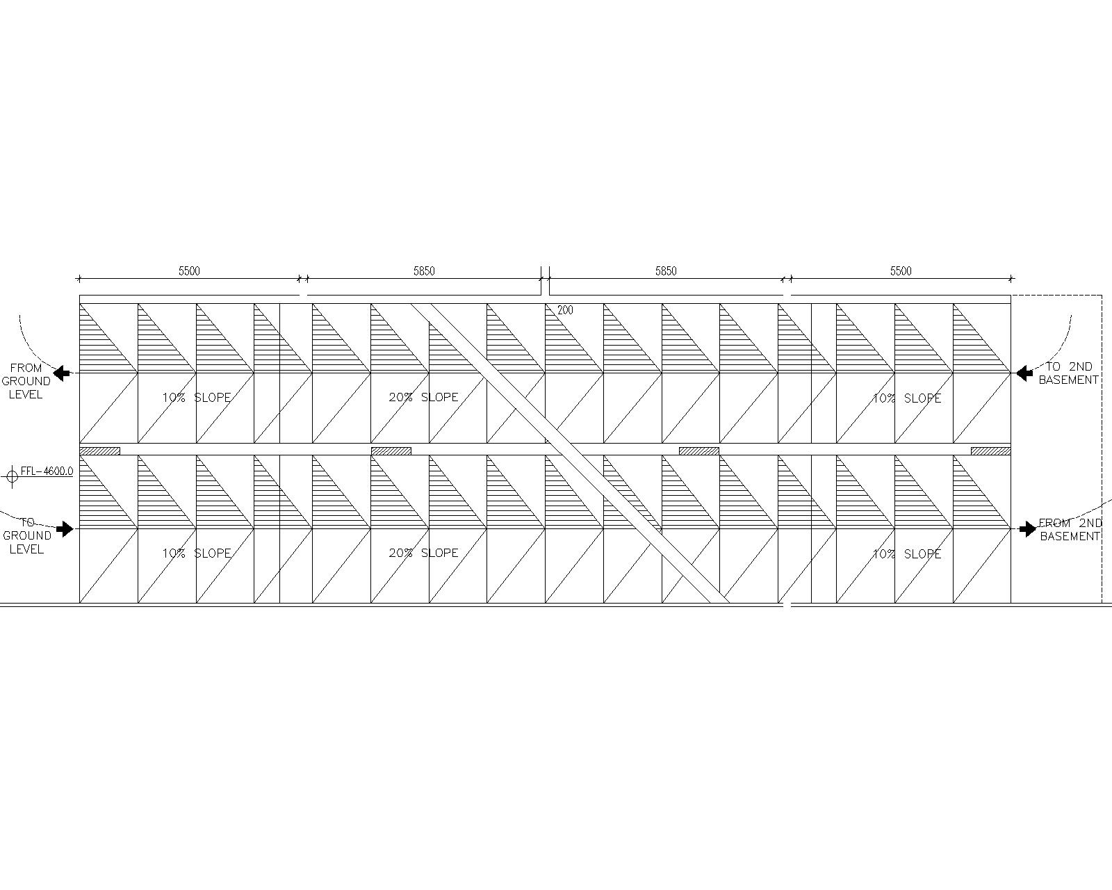

actually no not 3d what i meant ... please see the attachement that shows what i need . this was an acad drawing ...

but i think the ramp tool in revit is stupid . it doesnt cut with the plan cut line . and its not calculated for shadows ..
and what i realy want is a good method to make  the  ramp well presented in 2d on the plans and sections ..... and what i specificly want is ( HOW TO MAKE THIS NICELY PRESENTED CUT WITHIN THE RAMP ) ??

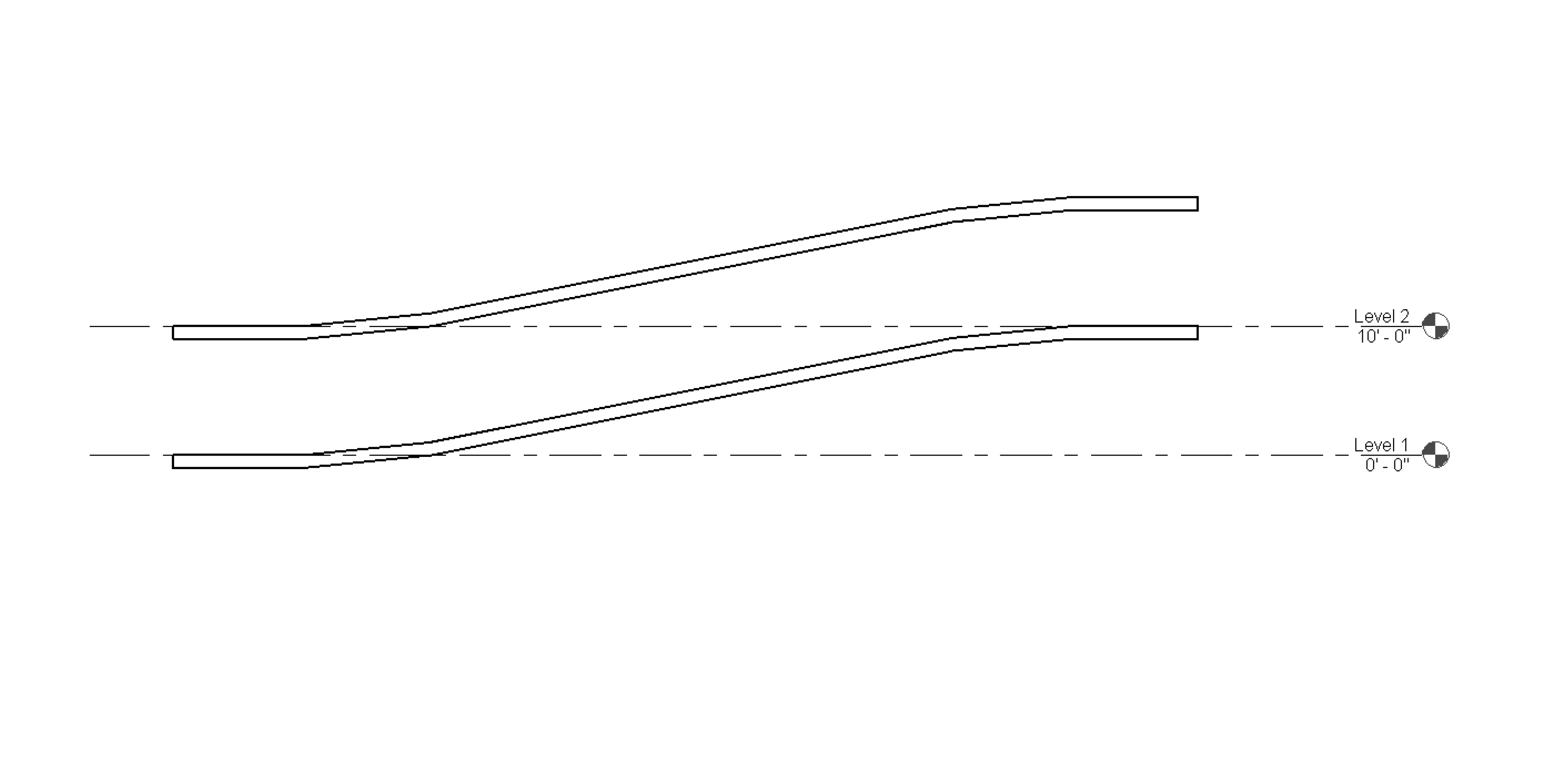

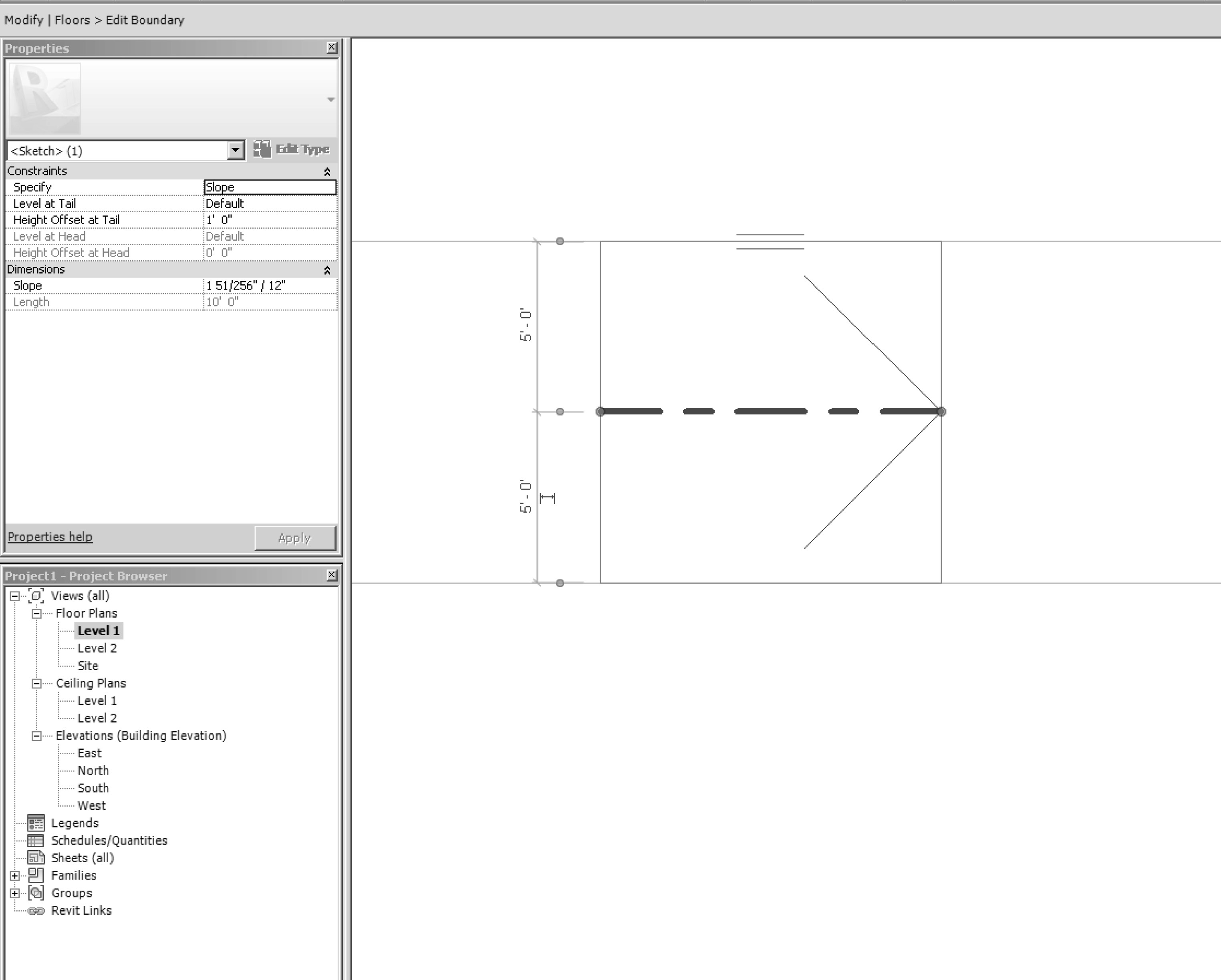

to create the diagonal cut line make a plan region in the view.  also use a floor with a slope arrow to create the ramps.
first i created the floor with slope.  in this case i made the slope arrow to be 1.2"/12" to get the 10% slope.  see image.
i created several of these floors and joined them together using the join geometry view. see section view.

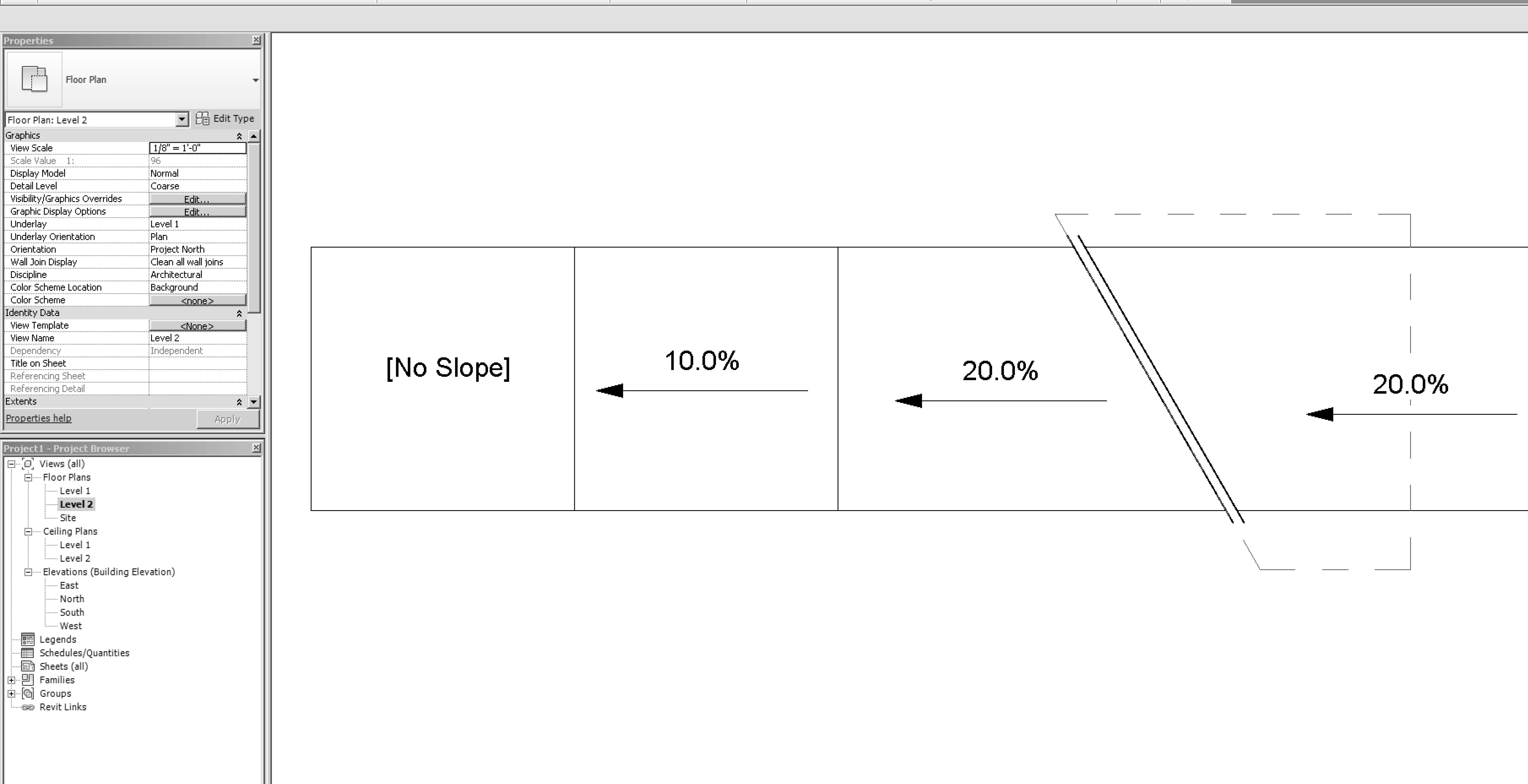

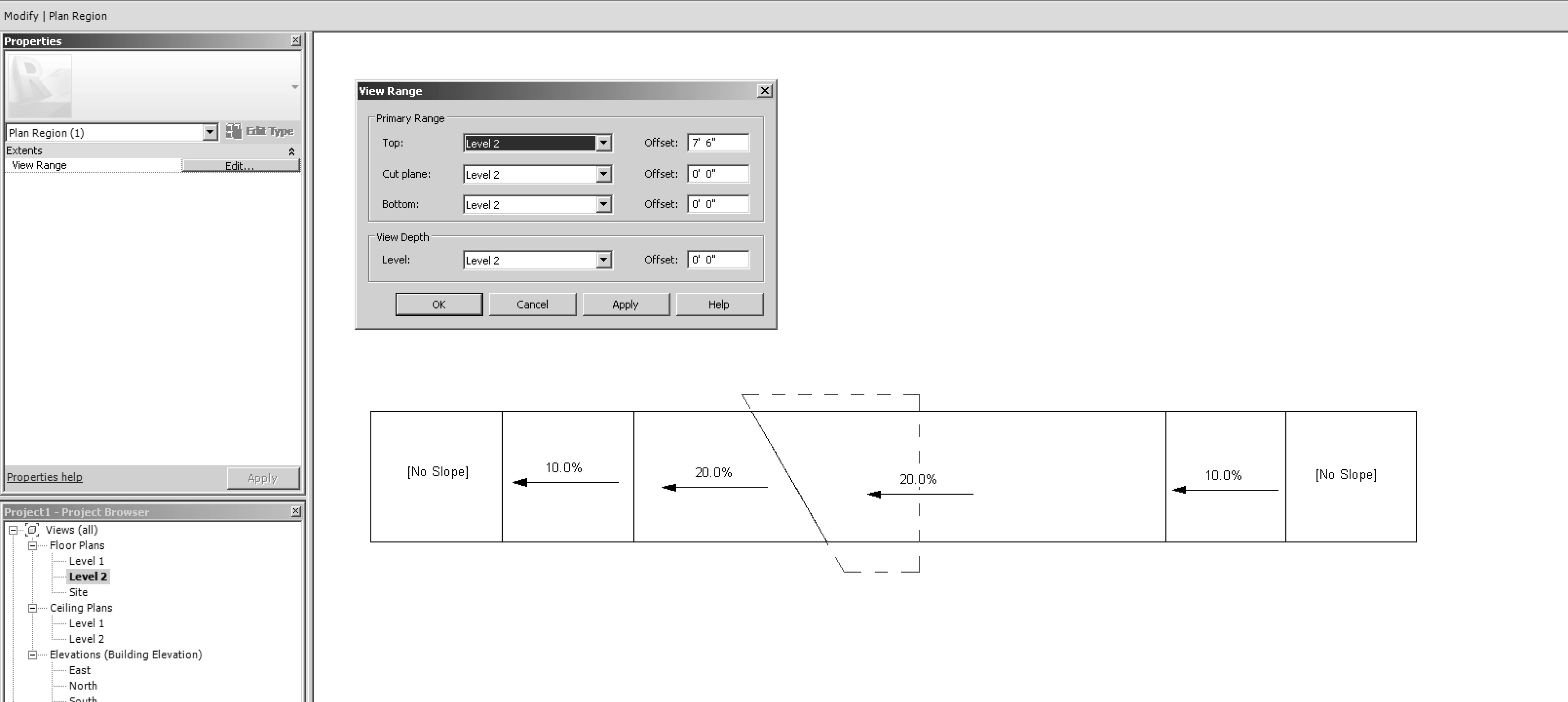

then in the 2nd level plan view i created a plan region set to 0" above level 2.  the plan region was drawn at the desired angle to give the diagonal cut.  also you can see the ramp to the right coming up from below.  the plan region dashed outline will not print.  see image.
lastly, the only reasonable way i could find to get a double cut line, if its necessary, is to create a solid white filled region.  other than this the graphics are all up to you.

thank you so much that was what i want but you said: " the plan region was drawn at the desired angle to give the diagonal cut "
how did you do that !
thanks,
Tue, Jul 30, 2013 at 5:14:39 PM | ramps presentation
#10
RevitMaestro
Joined: Wed, Feb 28, 2007
18 Posts
in the plan region sketch mode, you can create the plan region to be in any shape you want, to create the desired diagonal cut.  draw the sketch lines in the diagonal that you want.

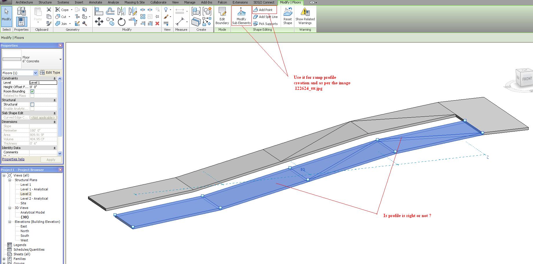

Thu, Jan 8, 2015 at 5:57:46 AM | ramps presentation
#15
blackcat052
Joined: Thu, Mar 15, 2012
0 Posts
i can't join them together cannot use " join geometry" . i don't know its mistake
