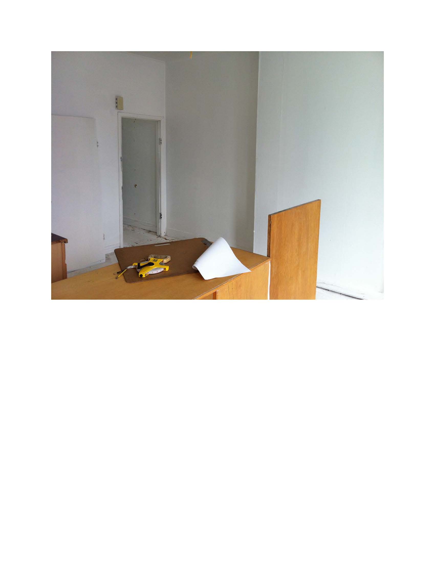

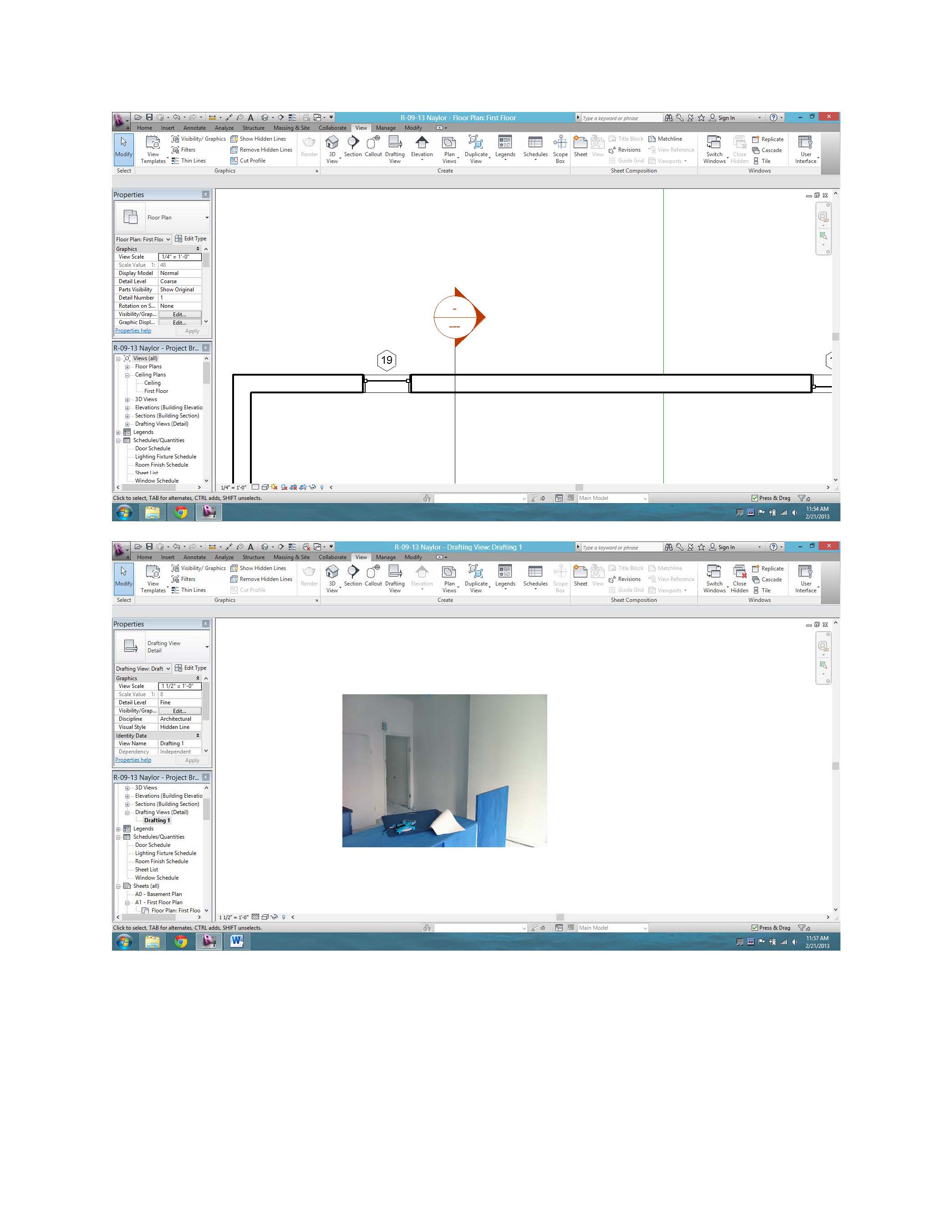

Hello All,
I just installed Revit 2012 on a machine running Windows 8 and the section marks show up in orange instead of the normal Blue. When I import an image, the colors of the image also get inverted. I am attaching screenshots of the section mark, the inverted image and the image in its regular form.
Tried reinstalling Revit, and it still does not work. If anyone could help me fix this,I would greatly apreciate it.

Hi all,
My computer is up-to-date with all the updates. I just noticed that it is just not the section marks that appear as as orange, but other marks (that are blue) like the floor level marks also appear as orange. I also noticed that any colors that are blue(ish) get converted to orange and anything that is orange or yellow(ish) get converted to blue.
I am guessing it may be the graphics driver on my computer that is not working well with Revit. I may need to see if there are any other graphics drivers I could use that may solve the problem.

The problem has to do with this update:
Platform Update for Windows 7 x64-Edition (KB267083Shadey
After installing this update, the section tags, highlighted text boxes, survey marker, etc is now inverted. I don't know the solution, but I do know the cause.

Try going to the "R", options, graphics and uncheck the use hardware box.  Then restart your project.  Worked for me.

This worked. Thanks a lot!! You are God and I bow before you.
So,  in concusion, to fix this problem:
1) Those using windows 7 can either uninstall the update that is causing the problem or use this procedure.
2) Those using windows 8 (which has the update built in to it),  the only way is to uncheck the graphics box under "R"
-B
