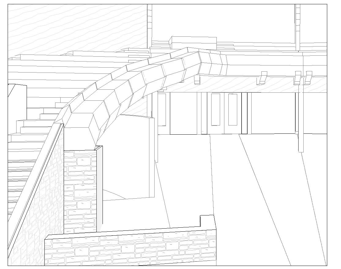

When I sweep a non-circular profile down a 3-dimensional path, the vertical axis of the profile rotates
as the path changes direction. Is there a way to keep the vertical axis vertical so my profile is oriented correctly
as it sweeps down the path?

The path is on a series of reference planes in order to get the 3D effect. I have tried to set the planes a variety of ways
to try and make the profile axis stay vertical, but it always twists as the angle changes. I tried a similar sweep in sketchup
and had the same effect, although not quite as severe. I think the computer twists it to make the changes in direction
clean up better.

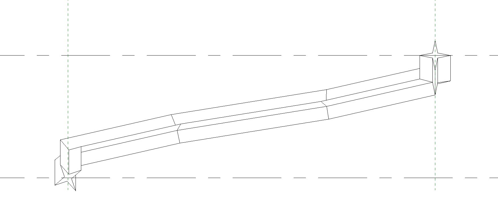

Swept Blend does not allow more than 1 line segment.I did it that way, with a bunch of swept blends, but the don't clean up well.
The rotate with component didn't seem to help, see attached image.

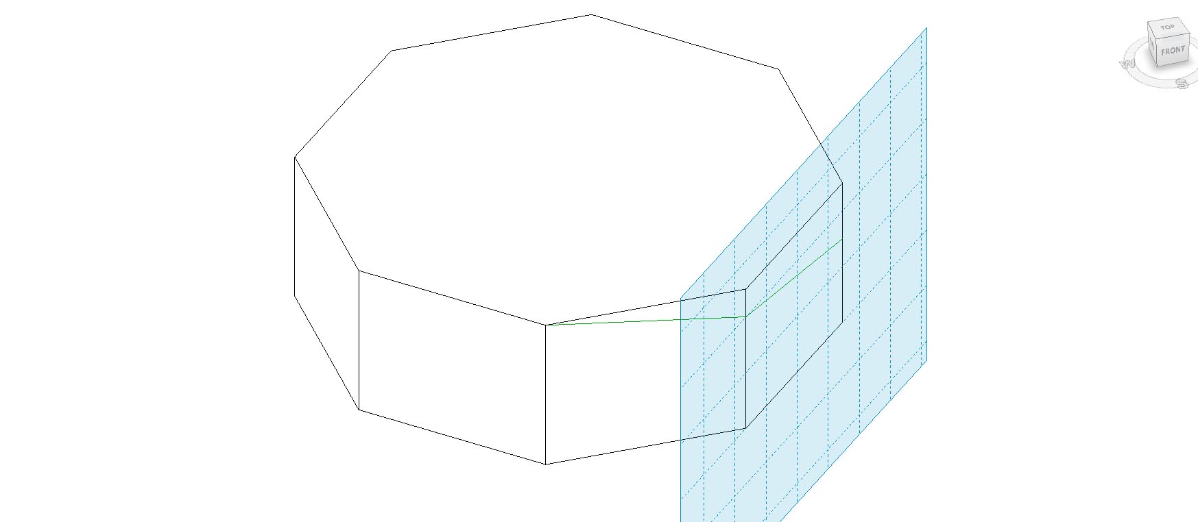

And all my reference planes are perpendicular to the ground plane. I created them using a mass with vertical sides, see image.

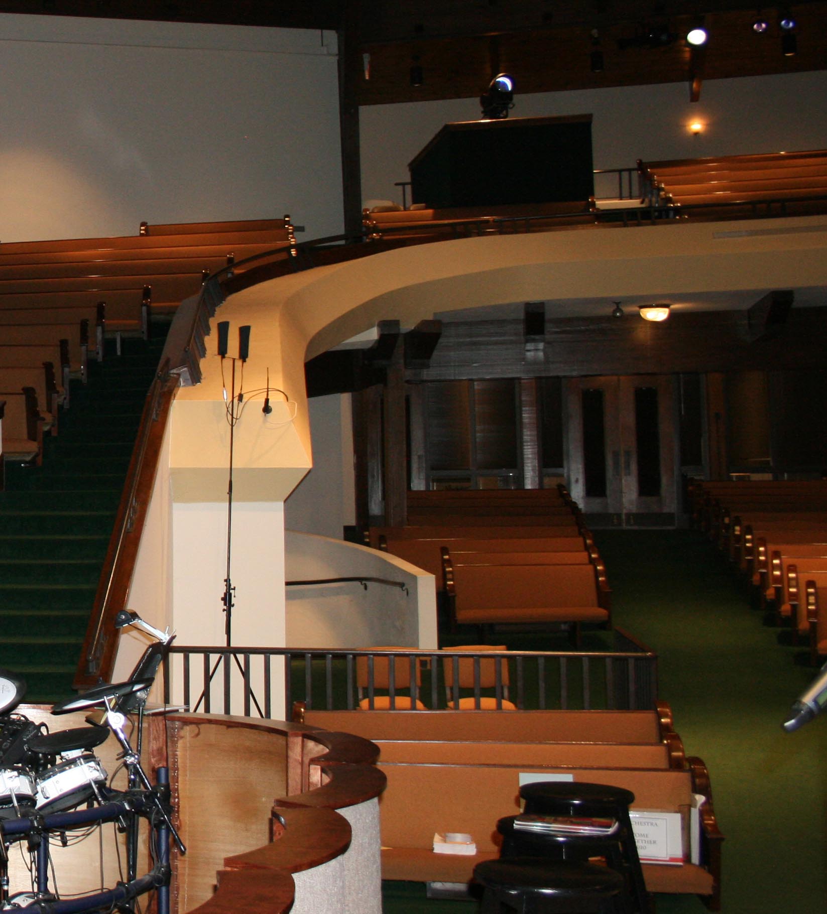

I am trying to recreate a balcony condition at an existing church.
Thanks for all the help, btw.

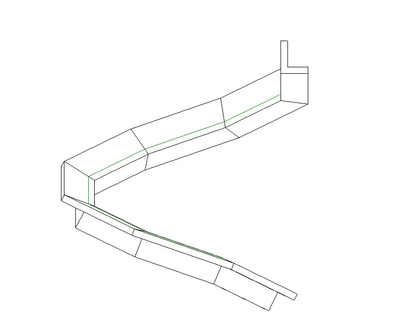

This was the best I could get using a series of swept blends.

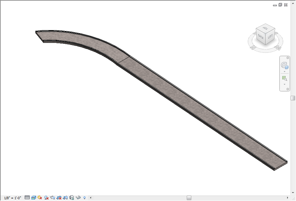

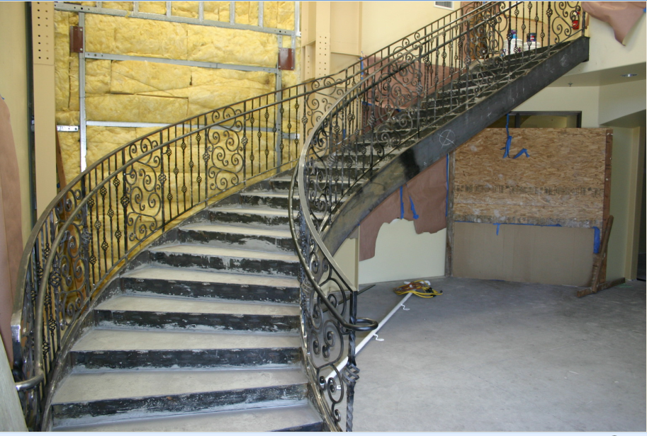

Attached are two simple methods of creating ramps if that is what you are after, they are both roadway oriented but could be any section. The last is a half spiral stairs under construction that I designed a few years back on Revit, and using Robot for the analysis.

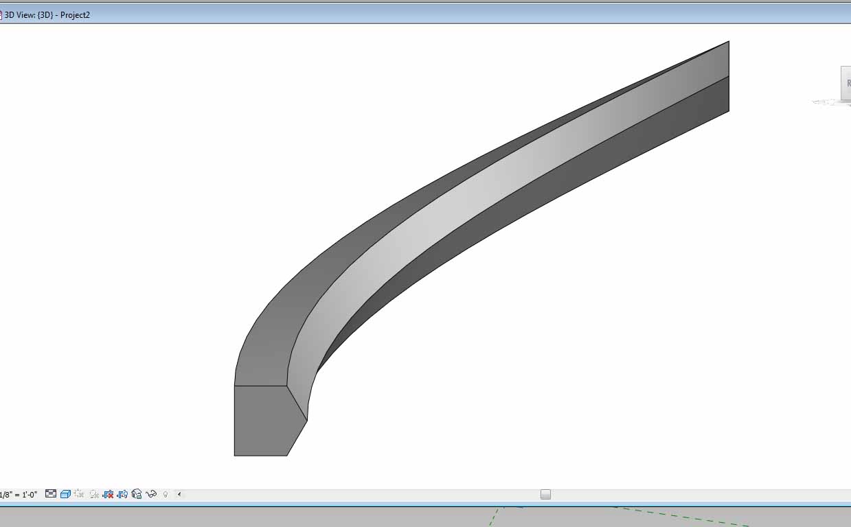

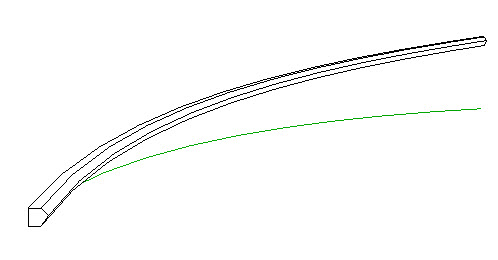

a swept blend can also have a curved path.  But only one arc.  That's still plenty powerful, however.  You could make this railing in 1-2 segements, I think.  pic related.

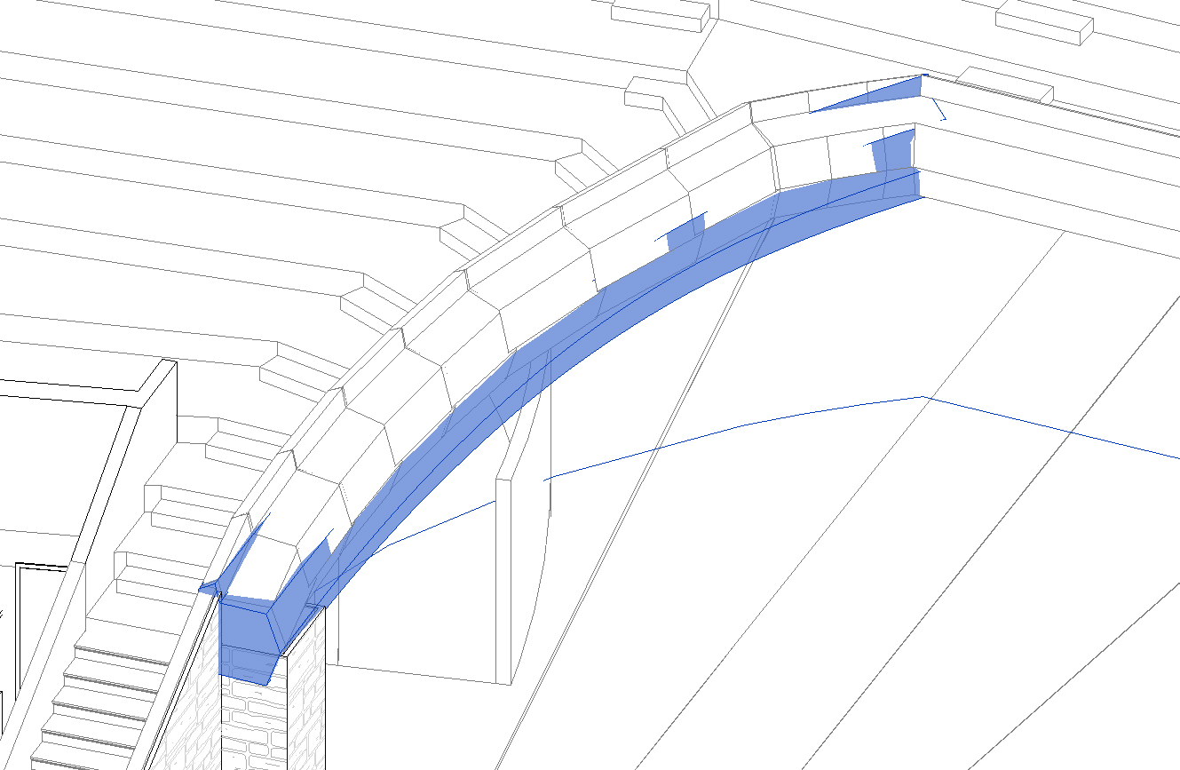

It is an arc, but the path it follows doesn't have consistent slope, so one swept blend won't work. I tried (see pic)
but the highlighted blue arc doesn't follow the true path of the balcony. I could change the segmented swept blend paths
to arcs, but trying to figure out their individual paths is going to be tough.
