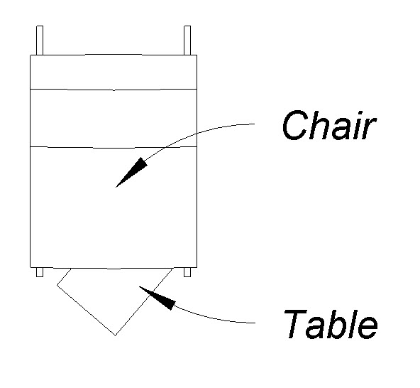

new member here using revit 2012. trying to see if anyone can answer this question related to family creation:
my company wants all extrusions off in 2-d and to be represented by masking regions/symbolic lines... drawing these is no problem... the problem starts when i bring them into a project.
for example: sometimes in the plan view chairs show above a table when obviously they would be underneath it. there does not seem to be any consistency to this though because in other instances the objects look fine in relation to the way they should look.
i have tried drawing the masking region on a specific work plane within the family but that doesn't seem to affect the result when i bring it into a project.
any insight??

I am talking about within the PROJECT. I attached a snip and as you can see a laptop type side table is being shown beneath the chair when in reality it is above it of course. The most frustrating thing is that in other instances this table will appear above other chairs as it is supposed to. There doesn't appear to be any rhyme or reason to how this works so hopefully someone here can help.

Fri, May 25, 2012 at 6:33:18 AM | Masking region hierarchy
You really don't give us enough information to help furthur.
Are these in the same family?  If so, then what we said still applies.
If these are seperate families and they both have masking regions, did you set the offset off the floor for the table?

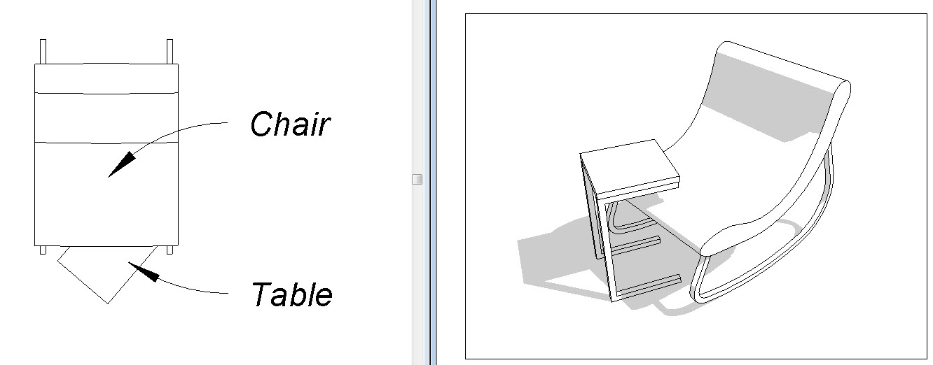

Sorry again... Let's back up a bit and think of this as a general question... if every family in a project has only masking regions visible in plan view... how does Revit determine which objects are above or below other objects?
back to my specific case... yes, they are two separate families in a project. They also both sit on the same floor plane. I attached another pic for clarification. Could you explain your offset comment a little further?
Fri, May 25, 2012 at 8:25:12 AM | Masking region hierarchy
Did you read this?
There is no hirearchy.  If they are both at the same elevation, you have given Revit no rules!  So you need to set the instance properties (location - level offset) of the table to be somewhere above the level of the chair.

Your initial post was about 2D plan objects.  Now you are asking about what we call 2 1/2 D objects.  Families that have a 2D plan and at least one elevation in 2D.
And my answer was related to how the family looks in the project. You now say you don't have that option in the family.  If you have these two objects in a family, then draw it correctly!  Don't draw two seperate masking regions - draw 1 and linework overtop that as appropriate.
I really wish you would be more complete in your questions.
Remember - you are using 2D elements but you are wanting it to act like 3D.  Very hard to do sometimes and this is one of those times.  When we have tops like this that may need to cover other 2D objects, we will ad a thin 3D extrusion that is only visible in plan views and is at the correct elevation in the family.

Fri, May 25, 2012 at 11:47:59 AM | Masking region hierarchy
#14
Create a family with just the table masking region.
Load that into your table family and set its offset (it will now show up in the family editor) to the correct elevation.
Your family will now work correctly.
