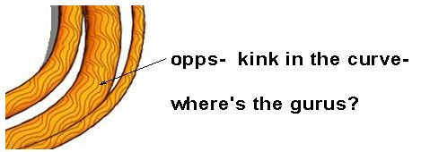

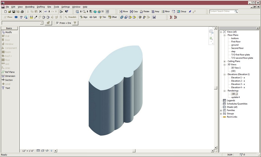

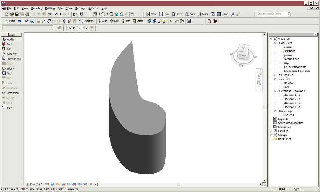

see here what i'm trying to do.. i did this extrusion
with spline lines.. but i don't want it to be irregular
like that.. how do i make accurate curves?

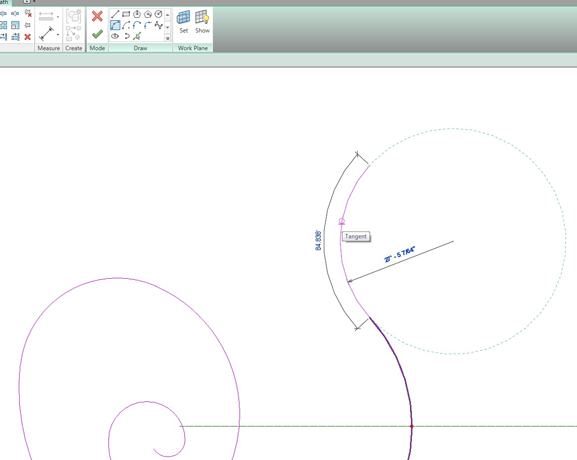

I would suggest using arcs, still.  Arcs will snap to suggest smooth transitions to the next segment.

when you go to draw your shape, there is the little box which has the pick lines, box, etc.  It also has the arc from center, arc from 3 points, etc.  Use either of these to get the shape you desire, splines, as you've noticed, don't allow any true accuracy.

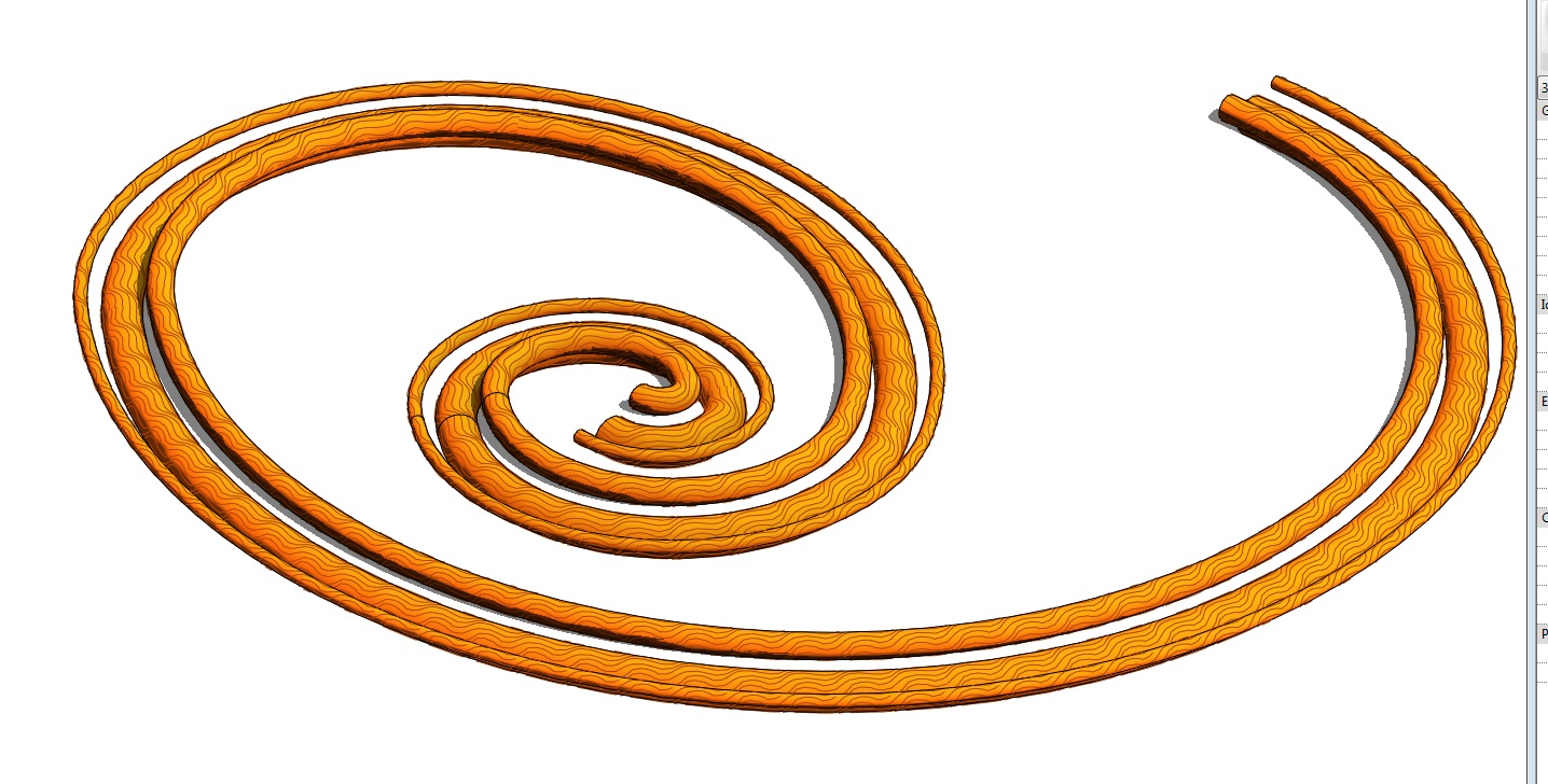

use start-end-radius arcs.  They will consider the radius of the previous line legment in your path, and snap to suggest a smooth transition.
attached are two pictures, of the snapping of the arc in action, and a sample flashy sweep which I find hard to resist doing.

I went out of my way trying to help you.  sorry, I won't try again.   I'm guessing the "gurus" learned this lesson long ago, and that's why there are no other responses.
The "kink" you are seeing is where one portion of the sweep overlaps another.  They're not on the same plane.  The sweep is three tubes, and it's an isometric view.

you showed my one long curve made with
pieced together arcs.. that leaves kinks and
bends in the thing..

the words "try again" was me trying to upload the
image for the third time.. in that image i was pointing
out the "kinks" or bends in the continuous curve- like
what i posted originally with an image showing that
problem..
