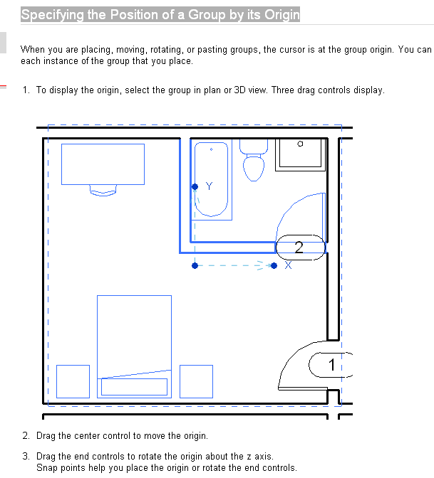

Tue, Feb 1, 2011 at 10:57:52 AM | Hotel rooms as groups
If you read your HELP < Specifying the Position of a Group by its Origin >, you will see that you can define the orgin ofyour group.  For rooms, we use the inside finish corner of the deizing wall and the corridor wall.  NO REASON TO USE A MODEL LINE.
