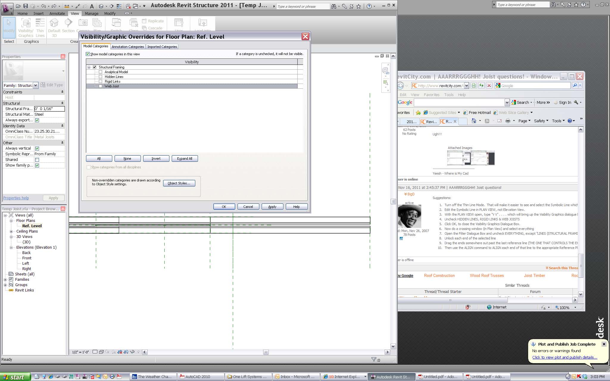

OK, try this.  With the family open in the Plan View,
Open the Visibility Graphics dialogue box (type VV)
On the Model Categories tab, turn off Hidden Lines, Rigid Links & Web Joists, click OK.
Now there's only ONE symbolic line showing, and it's the one you need to edit.  Follow the steps that I gave you before for editing the ends of that line.
Have fun and let me know how it goes.  I'll be around for about 2 more hours today.

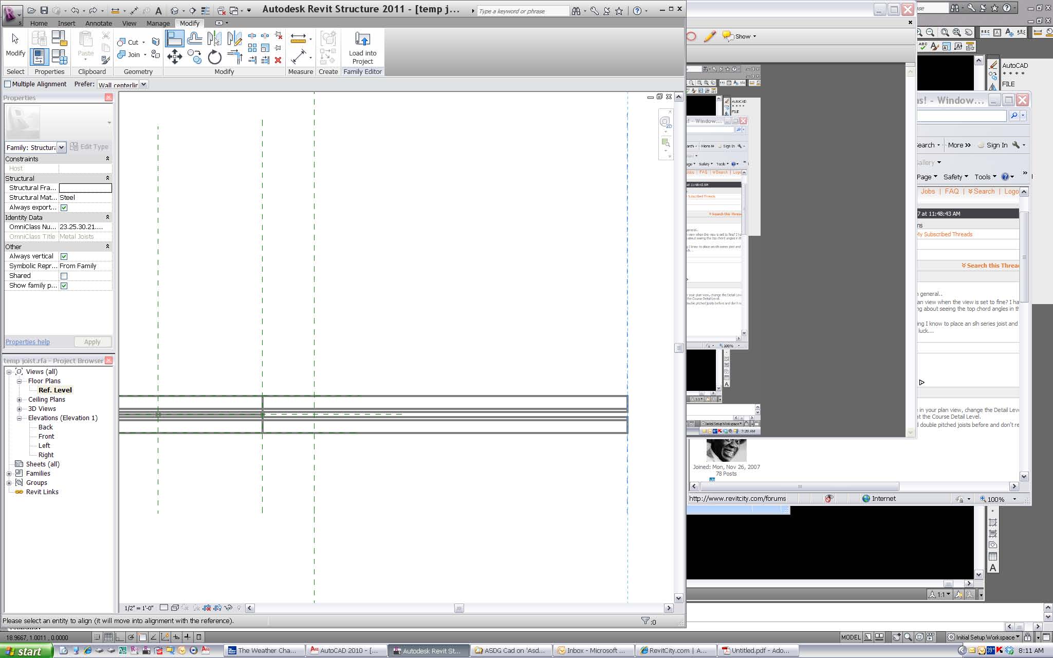

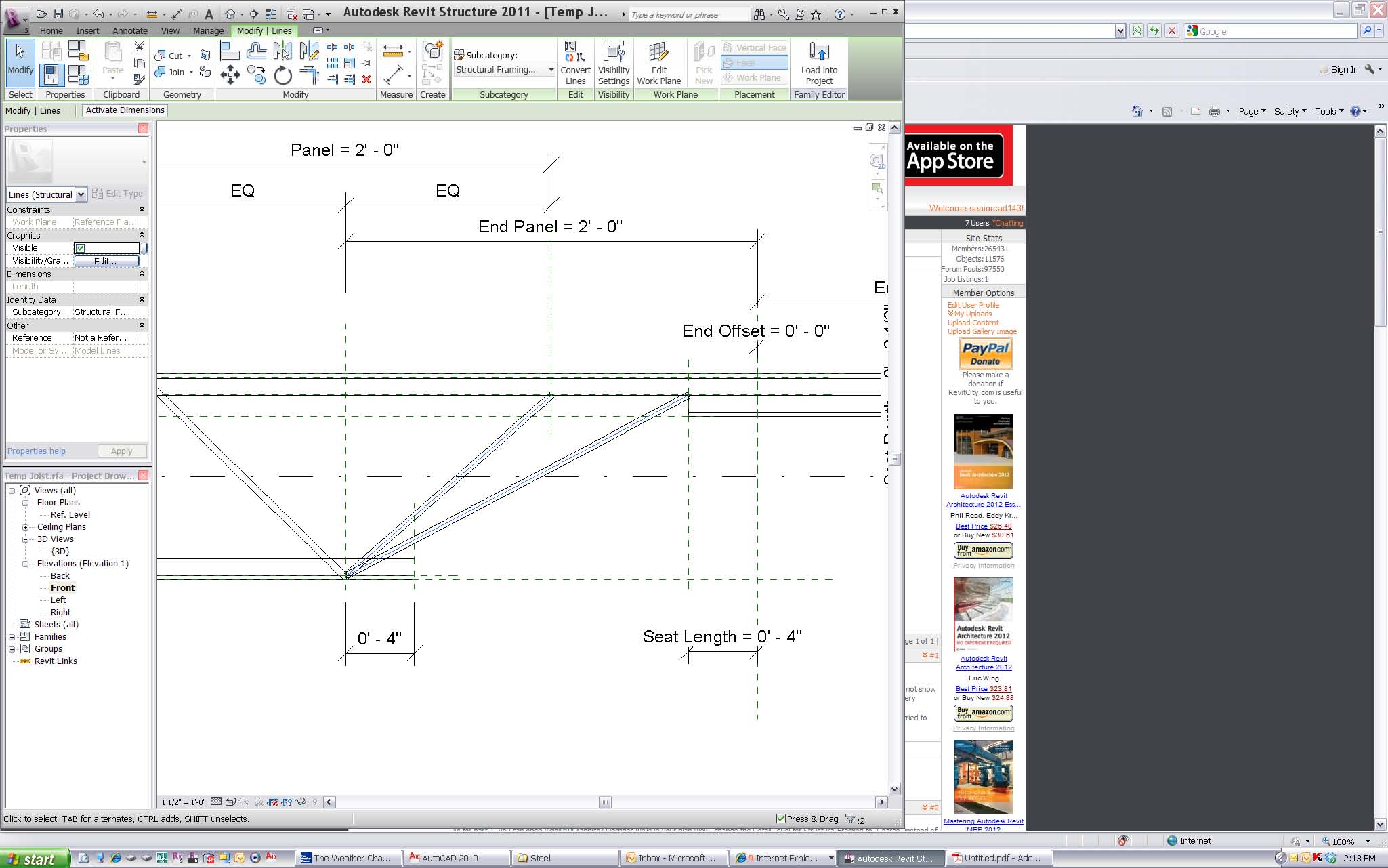

Wed, Nov 16, 2011 at 2:14:31 PM | AAARRRGGGHH! Joist questions!
#12

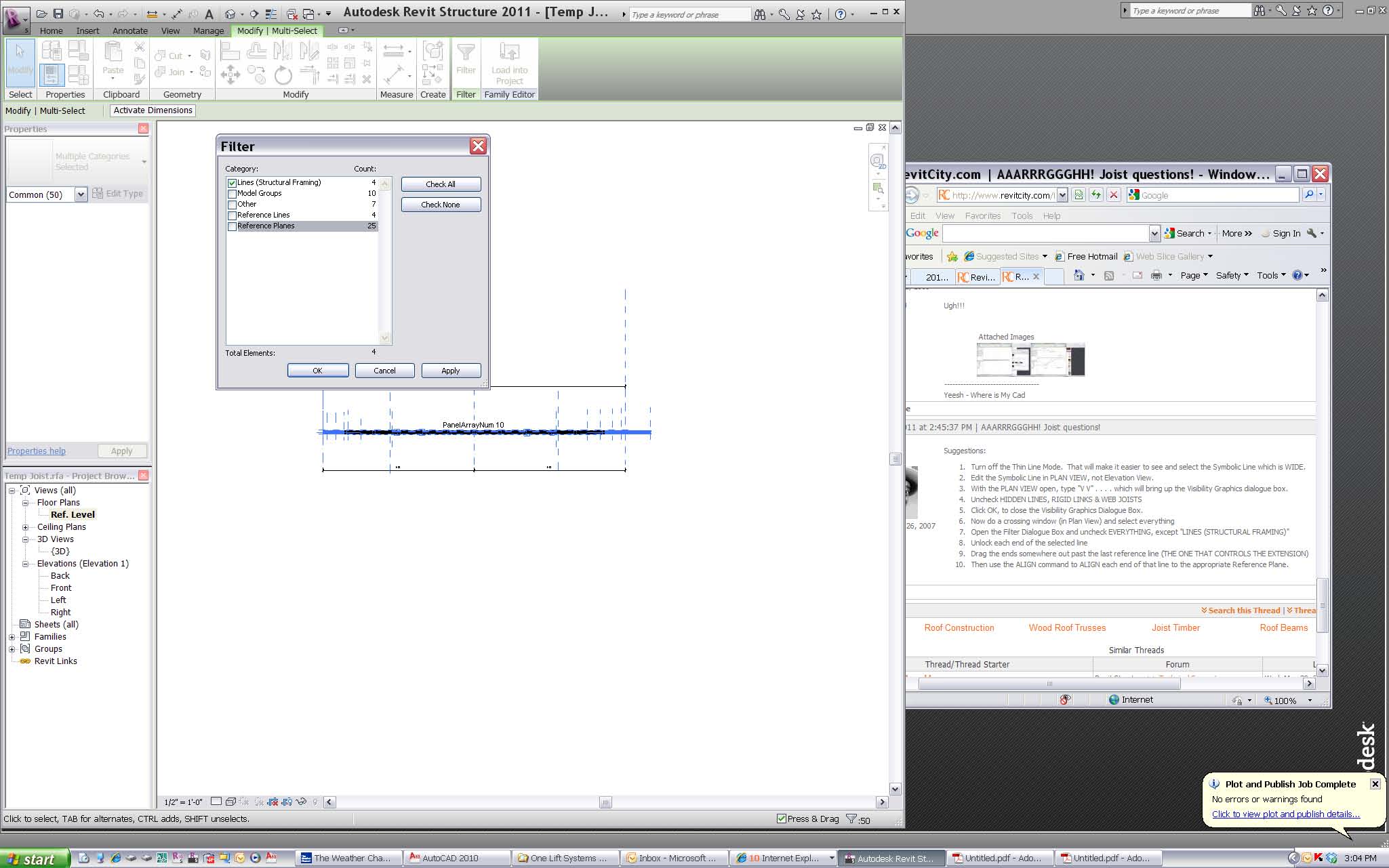

seniorcad143
Joined: Fri, Oct 2, 2009
140 Posts
1 Stars: 1 Votes
OK this is what I got when I did this. (Below)

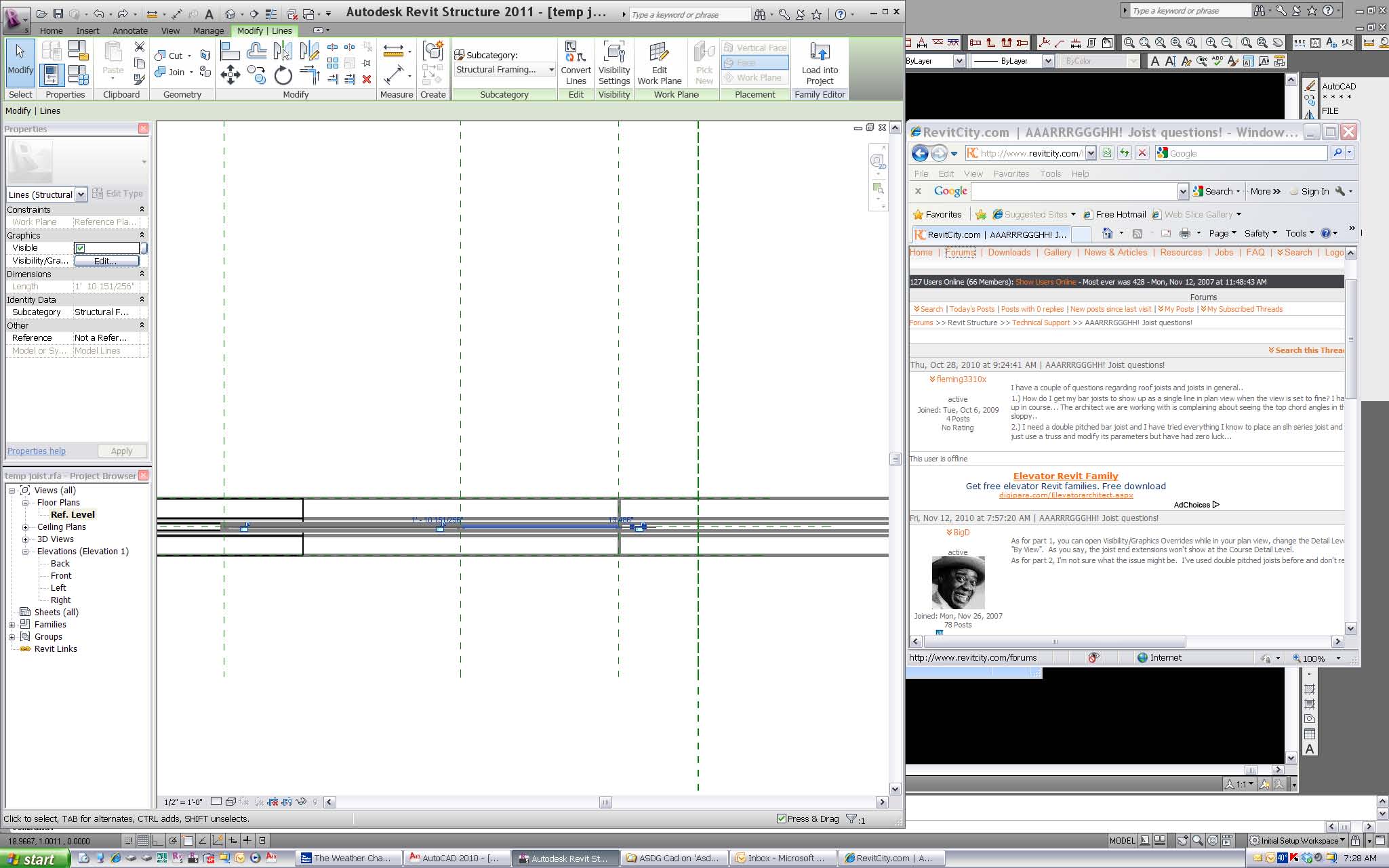

I did the crossing thing and filtered out everthing except the structrual framing lines (2 of them) and this is what I have left.  Those are the two lines for the angled web members.

Wed, Nov 16, 2011 at 2:45:37 PM | AAARRRGGGHH! Joist questions!
#13
BigD
BigD Avatar
Joined: Mon, Nov 26, 2007
100 Posts
1 Stars: 1 Votes
Suggestions:
  1. Turn off the Thin Line Mode.  That will make it easier to see and select the Symbolic Line which is WIDE.
  2. Edit the Symbolic Line in PLAN VIEW, not Elevation View.
  3. With the PLAN VIEW open, type "V V" . . . . which will bring up the Visibility Graphics dialogue box.
  4. Uncheck HIDDEN LINES, RIGID LINKS & WEB JOISTS
  5. Click OK, to close the Visibility Graphics Dialogue Box.
  6. Now do a crossing window (in Plan View) and select everything
  7. Open the Filter Dialogue Box and uncheck EVERYTHING, except "LINES (STRUCTURAL FRAMING)"
  8. Unlock each end of the selected line
  9. Drag the ends somewhere out past the last reference line (THE ONE THAT CONTROLS THE EXTENSION)
  10. Then use the ALIGN command to ALIGN each end of that line to the appropriate Reference Plane.
Wed, Nov 16, 2011 at 3:10:17 PM | AAARRRGGGHH! Joist questions!
#14

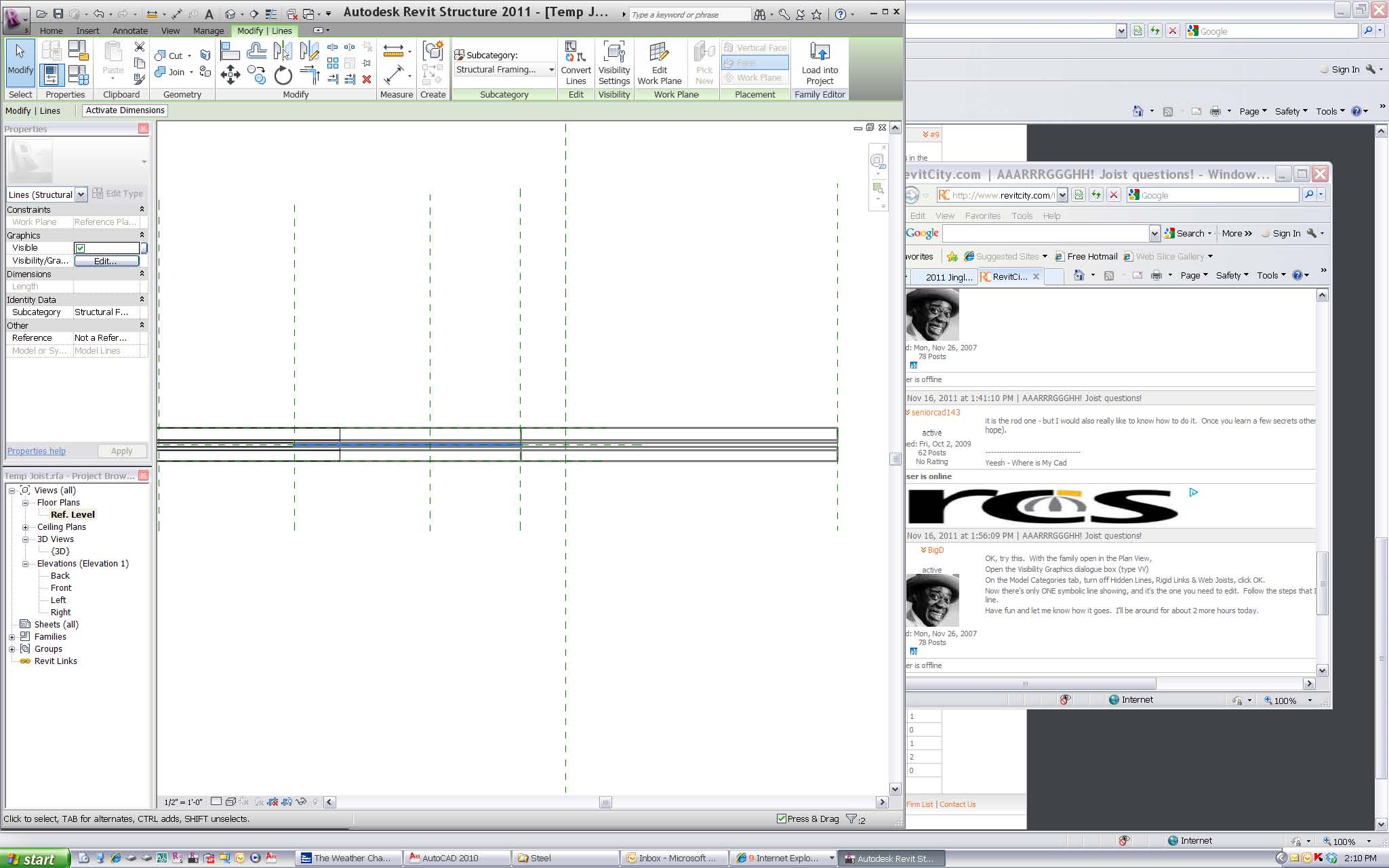

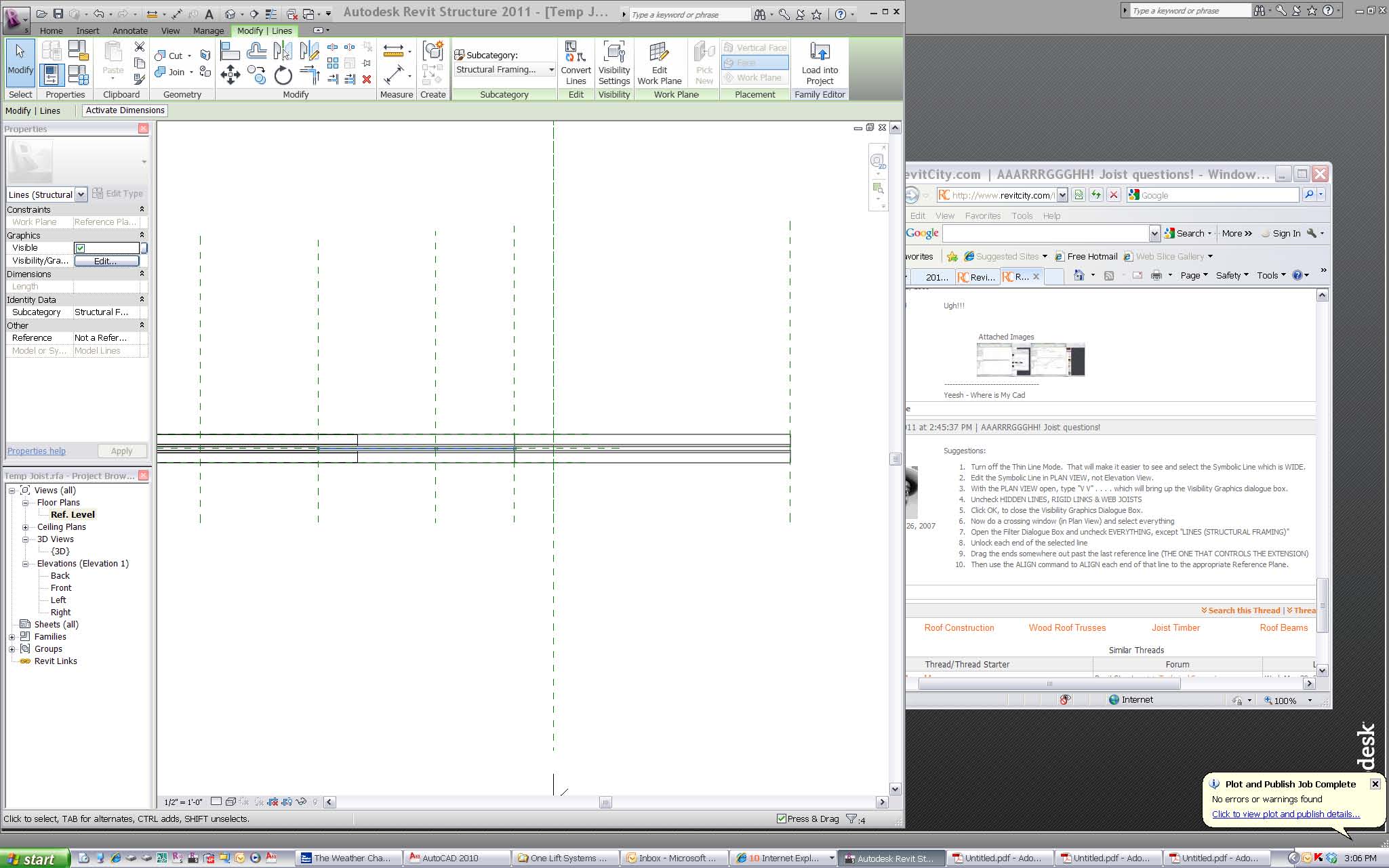

seniorcad143
140 Posts
1 Stars: 1 Votes
OK - i hate to sound stupid - BUT - I did all this.  it leaves me with 4 lines to choose from, but those 4 lines are 2 lines on each side of the joist that is the center of the rod at the ends of the joist.  (I can see them in elevation when I open up the elevation view.)  I don't think that is the correct line.  There is no other line.
Can I cry now?
Yeesh - Where is My Cad
Wed, Nov 16, 2011 at 3:27:14 PM | AAARRRGGGHH! Joist questions!
#15
BigD
BigD Avatar
100 Posts
1 Stars: 1 Votes
Just from looking at the image that you sent me, firstly it looks like you still have Thin Line Mode on which kinda makes it difficult to see those big wide lines we're looking for.  But, it looks like maybe the those lines are not visible anyway.  The only thing that I can see down the center of the joist is a reference line.  Check in Visibility Graphics and make sure that the box beside "Structural Framing" is checked, and the other 3 boxes below it or unchecked.
If we were in the same room, or in a Go-To-Meeting or something, I'm pretty sure we could fix it.  If you have Go-To-Meeting (or something similar), I'd be glad to do an online session with you.  It would only take about 5 minutes.
But, I've fixed a K series Joist family for you and attached it.  Maybe you can reverse engineer it or something.
