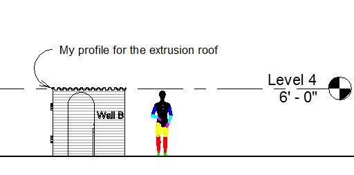

My question wasn't very clear. In fact I don't want a slope on my roof but I want to incline, to lean  it.
my profil looks like  multiples semcircular line( corrugated iron). The result of the extrusion works very well, but I want to incline the roof.
For example, when I am in my elevation view , I can select my roof and if I could rotate it, it would be very nice but Revit said "Can't change plane of Roof Sketch."

Please tell me that you are drawing the extrusion profile in a elevation view and not a plan view??? roof extrusion need to be drawn in elevation and that how you set the slop just like Typhoon said!!

Yes I drew my extrusion roof on the elevation view

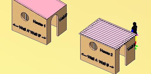

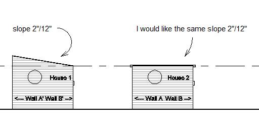

I put some images. I want to put a slope on my extrusion roof on the House 2 as the house1, but of course the roof of the house 2 is a extrusion roof.

OK KNOW I SEE YOUR PROBLEM, GOTO A 3D VIEW AND CLICK ON THE ROOF, RIGHT NEXT TO THE ELEMENT TAB, THERE WILL BE A TAB CALLED "SHAPE EDITING" CLICK ADD POINT. THAT WILL GIVE YOU POINTS ON EACH CORNER OF THE ROOF. THERE YOU CAN SELECT THE POINTS AND CHANGE THERE LOCATION ON THE Z AXIS WHICH WILL GIVE YOU YOUR SLOPE.

can't u just cut a section through it and rotate it to the specified angle? That's what I usually do for a simple slope like that...

@Wolfmann: In my section view I can't rotate the roof it says"Error: Can't change plane of Roof Sketch."

...working with wolfmann's suggestion; in order to rotate the roof, you need to dissassociate it from the work plane first.
