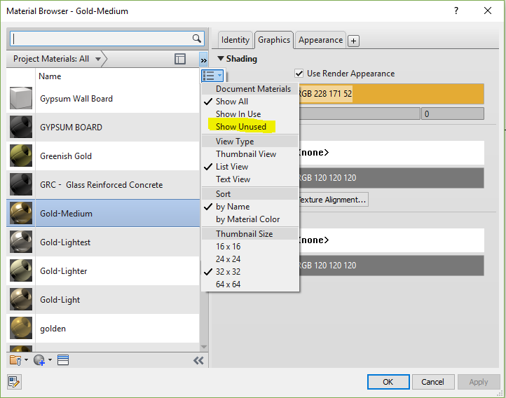

Revit has changed a lot over the years and I can't remember what it was exactly in 2010.  But as of 2014, I don't know what your problems are - see image!!!!

JUST IN CASE ANYONE STILL NEEDS TO KNOW, YOU MAY ALSO KNOW IF A MATERIAL IS BEING USED OR NOT

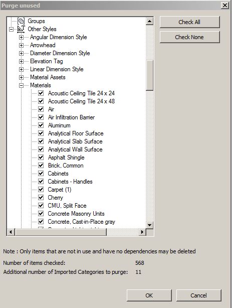

I would add that simply pulling up the purge will show you what materials are NOT being used.

If I were to open a fresh Revit Family Template for a GENERIC MODEL, included with it are a list of default materials (see screenshot). Things I'm referring to are like: Air Openings, Air Surfaces, and so on.
These materials are not "in use" because the template is blank. It hasn't been used for anything yet. Based on this, one would assume that simply using the "PURGE" function as many have referenced would delete these defaults but it doesn't. The only way I've been able to get rid of these is to delete them one-by-one in the MATERIALS dialogue box. Once I delete them there, I can use the PURGE function to get rid of the remnants of those materials.
