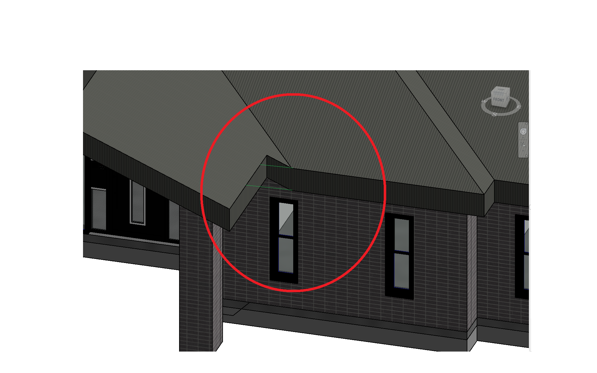

Im resurrecting an old thread which I started years ago. Would you believe Im getting more errors with my roof line for a portico.
Can someone tell me why there is a roof error in the pics attached when I use the roof by footprint tool.
thanks.
Edited on: Mon, Jul 28, 2014 at 4:21:24 AM
Edited on: Mon, Jul 28, 2014 at 4:22:31 AM
Edited on: Mon, Jul 28, 2014 at 4:22:59 AM
Mon, Jul 28, 2014 at 7:49:02 AM | Adding a Portico to a Roof
#15
Your eave heights are not the same.
You have to be careful using a combination of sketched and offset lines - sketch it all from the eave limit.
