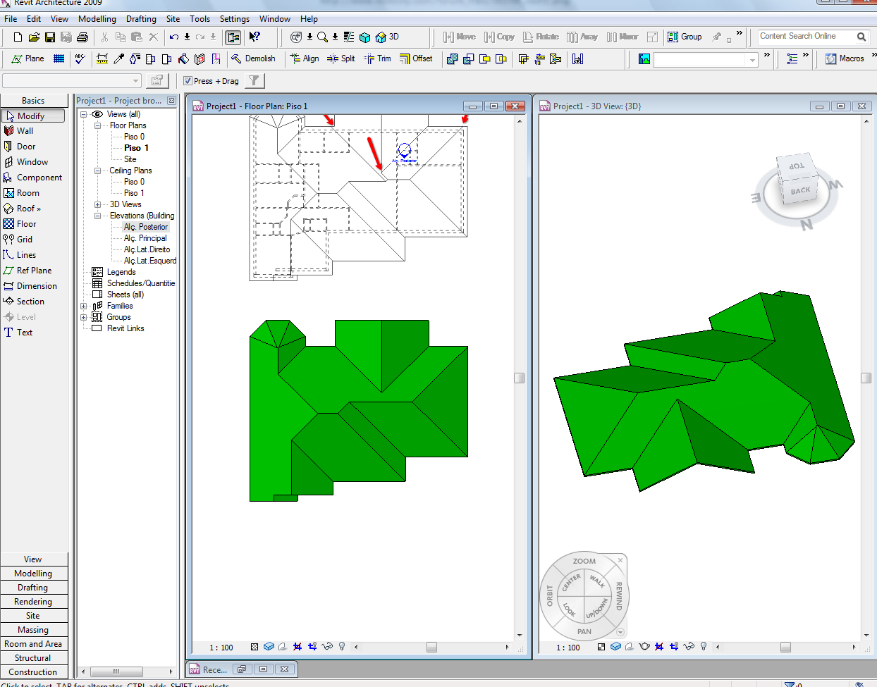

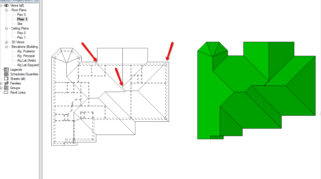

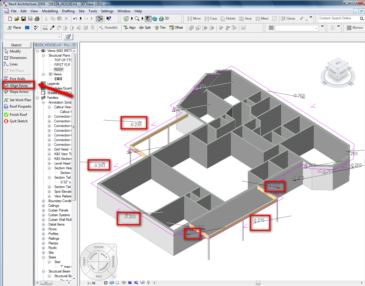

I am trying to use the roof command to put a fairly simple roof on a house.  For some reason the hip and valley lines are not going to the correct spot in some areas.  I have attached an image of what I am talking about.  Can someone tell me a way to get these to go to the correct location (i.e. corners)?
Thanks in advance.
Mike

sorry Typhoon, but i think your roof is incorrect also. that back gable should not continue and hit the ridge as you show it. it should  stay below the main house ridge from what i can see.

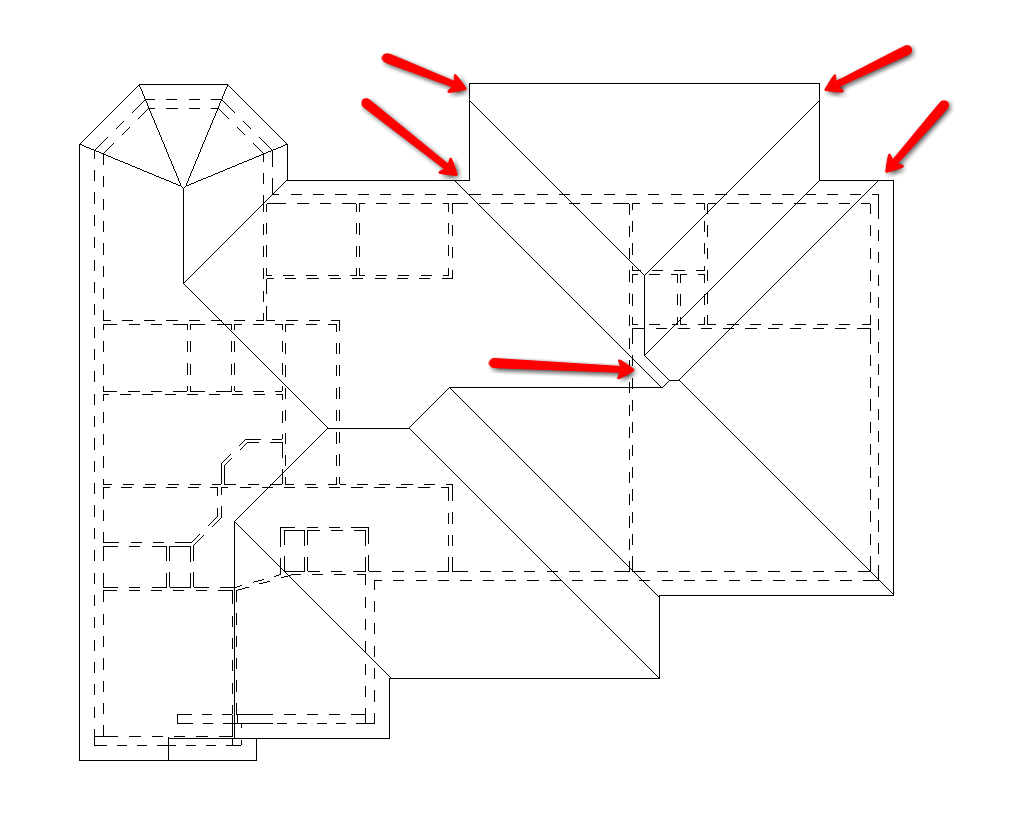

Sorry for that Coreed, there it is.....

Just a Roof by footprint....

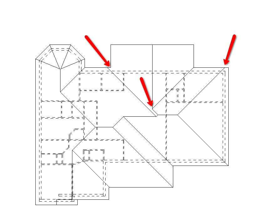

I have my perimeter walls. I go to the roof by footprint command. I give an overhang dimension of 1'-4". I then click on the "pick walls" command. I then set the "defines slope" command for the lines that define the slope and then change all of the angle to 6:12. I then click the finish roof. The attached image is what it spits out. The valley and hip lines should originate at the corners or intersections.
I am using Revit Structure 2009 if that makes a difference.

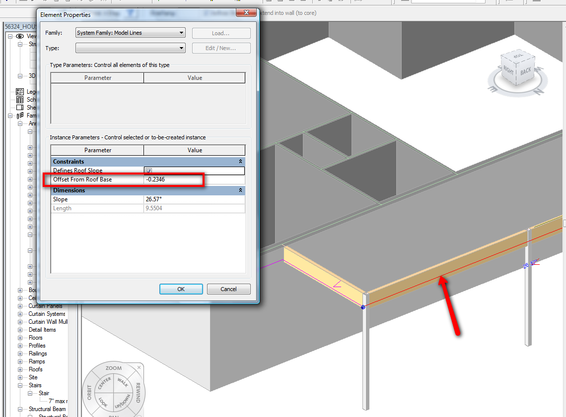

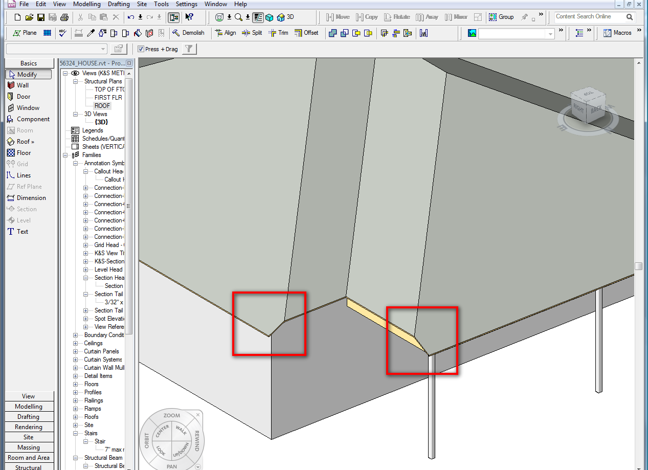

yeah, you lie, you also change "Offset from roof base" in some lines like you can see in the images, if you pick in the "Align eaves" you can see what i post, so, it's natural what it's happen....
