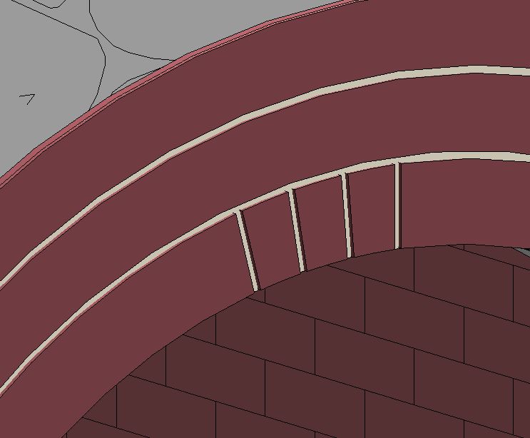

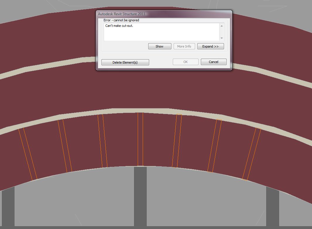

They are in the same family. "Walls". I created a few voids and it works fine. but as soon as i mirror the voids to the other side of the Rowlock like have done many times before with out a problem....it gives me this error. This is my first post so i hope you can see the attatched files.
Fri, Mar 11, 2011 at 5:12:07 PM | VOID form will NOT work!
roscogreene
Joined: Tue, Feb 15, 2011
4 Posts
5 Stars: 1 Votes
also if i reset the wall profile it seems to work just fine. any ideas?
Fri, Mar 11, 2011 at 6:25:25 PM | VOID form will NOT work!
#9
IloveSKETCHUP
Joined: Wed, Dec 17, 2008
25 Posts
usually when i get that error it is becuase there is an overlap in the voids. make sure the voids you are mirroring are not overlapping. Even if two cuts shares the same plane, try offseting by 1mm to see if it will cut.

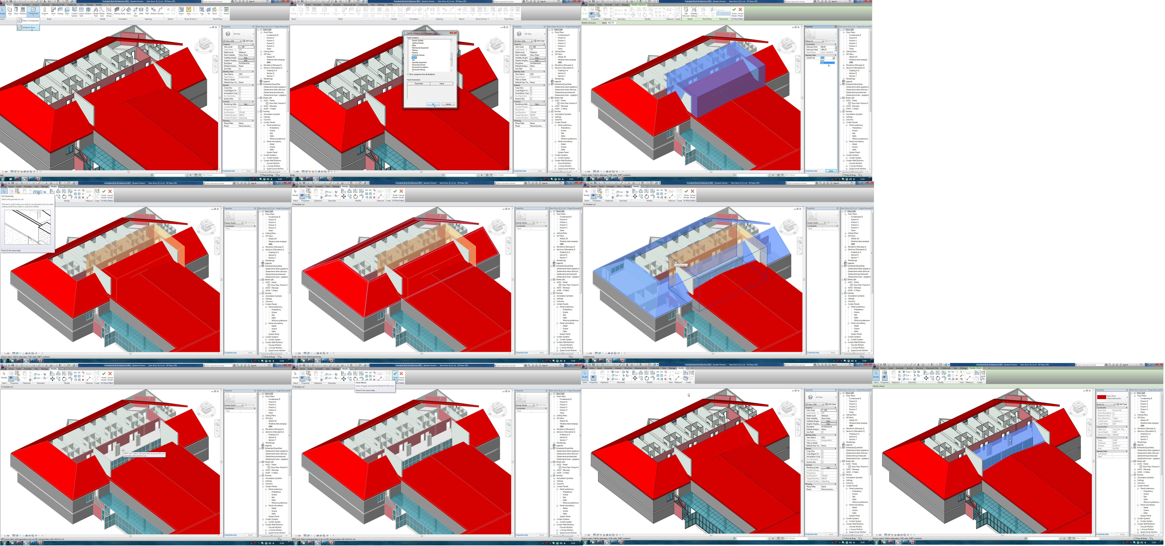

(revit 2012)
Facing a new aspect of the problem:
I'm trying to cut an excessive volume of a roof using void extrusion in an in-place component of the same category.
Everything seems to work fine except the fact that after finishing the component the cutout is replacedby the original geometry, as it has never been created. Has anyone else experienced a similar problem?
Sun, Jan 29, 2012 at 8:10:51 AM | VOID form will NOT work!
#12
It sounds like you created your void but failed to tell it what to cut.  Just creating it in the same category doesn't mean anything.  You might have several roofs in the same area so Revit doesn't know.... you have to tell it.
Please review your HELP on creating voids.
Sun, Jan 29, 2012 at 8:58:52 AM | VOID form will NOT work!
#13
bolwazy
Joined: Mon, Feb 1, 2010
7 Posts
The thing is that I have used "cut geometry" tool on the roof and the void form. It has worked, the intersecting volume was cut out. Put in other words, I have done as follows:
·         created a new in-place component of the "roofs" category
·         modeled a void extrusion intersecting with designated roof
·         used "cut geometry" tool on the roof and the void form
·         as a result got the desired geometry where the void form was successfully subtracted from the roof outside the component
·         clicked the "finish model" button.
·         The “fun” part: the subtraction disappeared as it has never been created.
·         As a final result I got a roof divided into two parts – one of them has a shape of the volume that should have been subtracted. Hiding that other part gives me a result similar to the desired effect but unfortunately it is not a universal solution.
Supposedly it is just a bug in my installation?

" As a final result I got a roof divided into two parts – one of them has a shape of the volume that should have been subtracted. Hiding that other part gives me a result similar to the desired effect but unfortunately it is not a universal solution." - If you posted some images would help but I believe you need to stretch that void extrusion to intersect the whole roof, then, use the cut geometry tool.
Mon, Jan 30, 2012 at 4:16:06 AM | Typhoon
#15
bolwazy
7 Posts
Quoting Typhoon from 2012-01-30 03:33:36
Here is the screenshot of the whole operation
