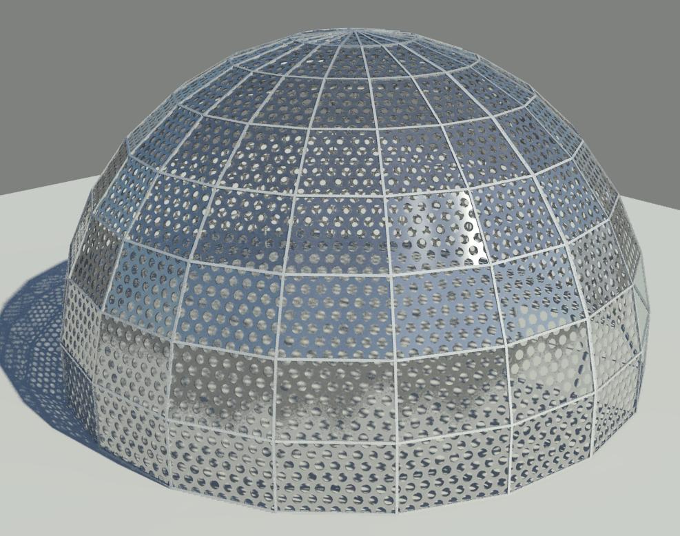

HI.
How can I create a dome of glass ( including curtain grid &  mullion )
Please help...
Similar to Attached Jpg..
Thanks in advance

Hi Bhobho, i can't see very well the image but create a dome like that it's very simple, first of all you must load the dome: "File - Load from Family - Load Family" go to folder "Mass" and choose " M-Dome", then insert the dome in to a floor for example, go to "Project Browser" "Families" "Mass" "M-Dome" pick and drag M-dome to your floor, and there it is the DOME, go to left menu and chose " Massing" then "Curtain System by Face" and select the two parts of dome and in Top menu pick "Create System", now you can delete the Mass and work in the curtain system...

Look the images... the material panel you can put what do you want, glass, metal, etc...

I have tried more than once in size amendment, but did not know?? Please help me

Can you wait when i create a video for you?

Ok * now I know >> thanksss
I have a question only.
When I create curtain system  ....it  Automatically create curtain grid how can I edit it

Ok this is the video:  http://screencast.com/t/v1hBHTe853
