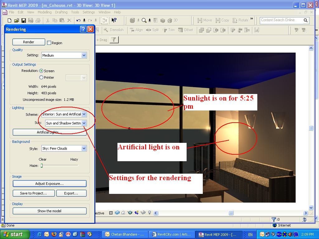

chiragpklg
Joined: Tue, Mar 25, 2008
90 Posts
4 Stars: 11 Votes
Hey guys do you mean sumthing like wht I have attached to this post please go through it & even the settings & do reply me whether i m right or not

Tue, Aug 12, 2008 at 4:18:37 AM | Artificial Lights DO NOT turn on in rendered scene
#9
Joined: Tue, May 22, 2007
5921 Posts
4 Stars: 205 Votes
Hi, do you turn on the "Daylights"?
Tue, Aug 12, 2008 at 4:22:32 AM | Artificial Lights DO NOT turn on in rendered scene
#10
chiragpklg
90 Posts
4 Stars: 11 Votes
Ya the "Daylight" is on.

Tue, Aug 12, 2008 at 4:34:02 AM | Artificial Lights DO NOT turn on in rendered scene
#11
5921 Posts
4 Stars: 205 Votes
Hi CHIRA, i was asking to VICOZZIO...
