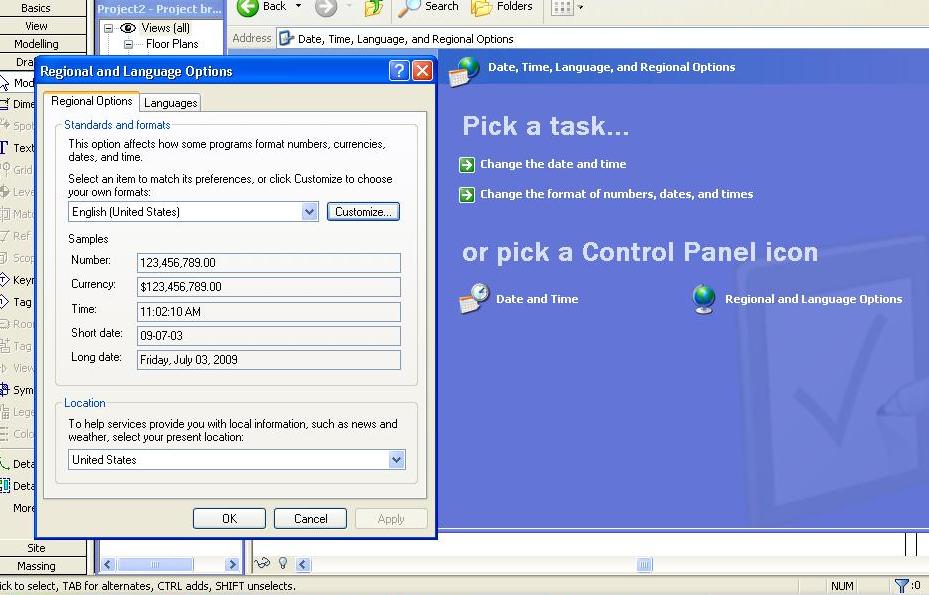

Simple...If your using XP then Click on Start>Control Panel, then Double click on Date and Time and then click on Change the format of nuber, date and time, then click on customize then click on date tab and select yy-MM-dd (or type) your own format. Then on time tab type h:m for time format field. Now you can have your format of date like 09-07-02 10:30. Here you can't eliminate time but you can eliminate seconds. See attched images.

Fri, Jul 3, 2009 at 1:00:24 AM | Format Label Date/ Time Stamp
#9
Pavan
Pavan Avatar
Joined: Sat, Mar 19, 2005
157 Posts
4.5 Stars: 3 Votes
For Vista users Open Control panel, double click on Regional and language options and click on customize this format and change the date and time as you like. Check the attachment
