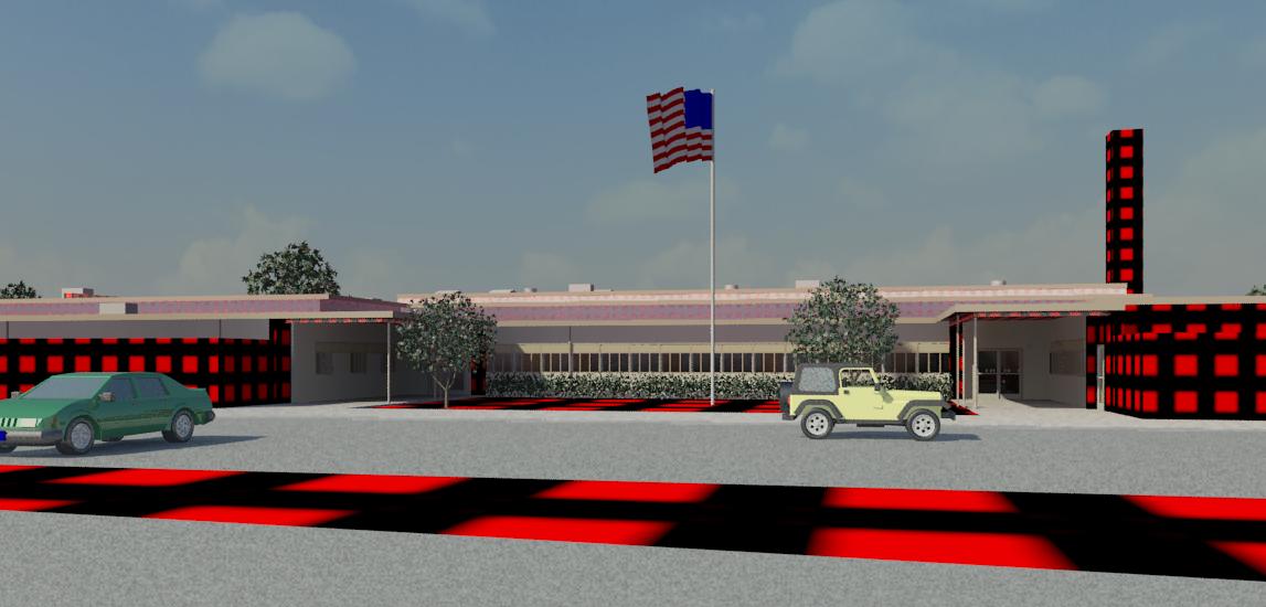

I am now running service pack 1 & 2 and I crashed 7 times yesterday and again first thing this morning. Then service pack 2 partially broke the rendering feature. Some 3d views will have textures randomly swapped out for a strange red and black pattern ... bummer!
