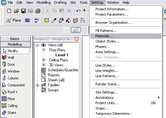

1. Open up Revit, start a new project and go to Settings > Materials

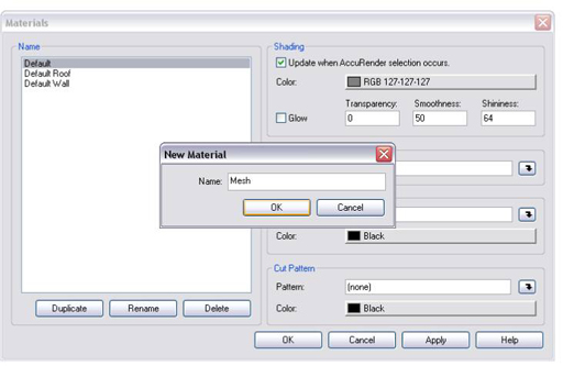

2. In the Materials dialog box, choose “Default” or any other material for that matter… and click Duplicate. The New Material dialog will open, type “Mesh” and click OK
