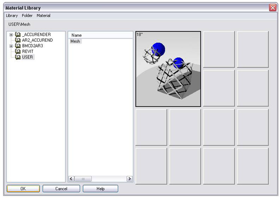

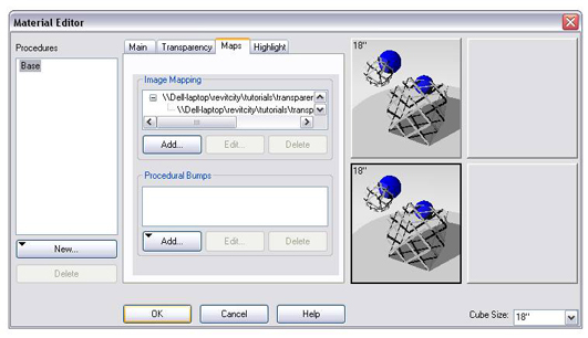

Simple as that! Now you have the stainless steel image mapped to your transparency map!
12. To save your material, click OK

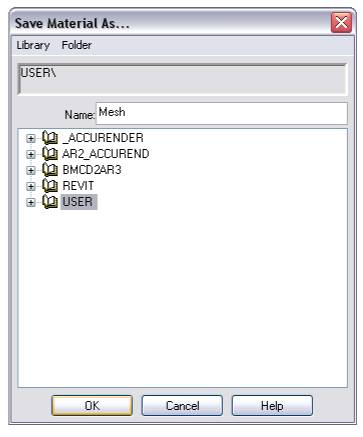

13. Under Save Material As… Give it the name you want, and click OK
14. Click OK to exit out of the Material Library

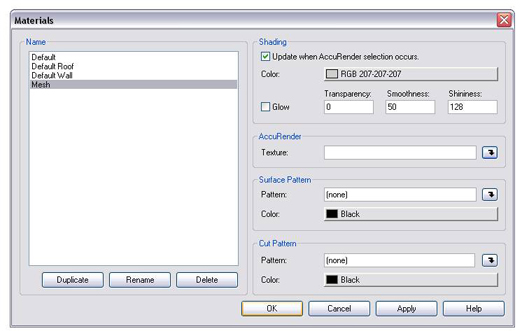

15. Click OK to exit out of the Materials dialog and save your material.
Now wasn’t that easy?! If you’re a Revit novice, hopefully this tutorial can serve as a gateway into the world of material manipulation. Your projects and needs will determine how much you get into it but this should provide a glimpse into the tools available to you. With that, I will leave you to exercise your creative genius as I retire to suffer through a re-run of The Apprentice.
