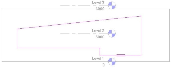

In the section view draw the outline shape picking the edges of your opening.

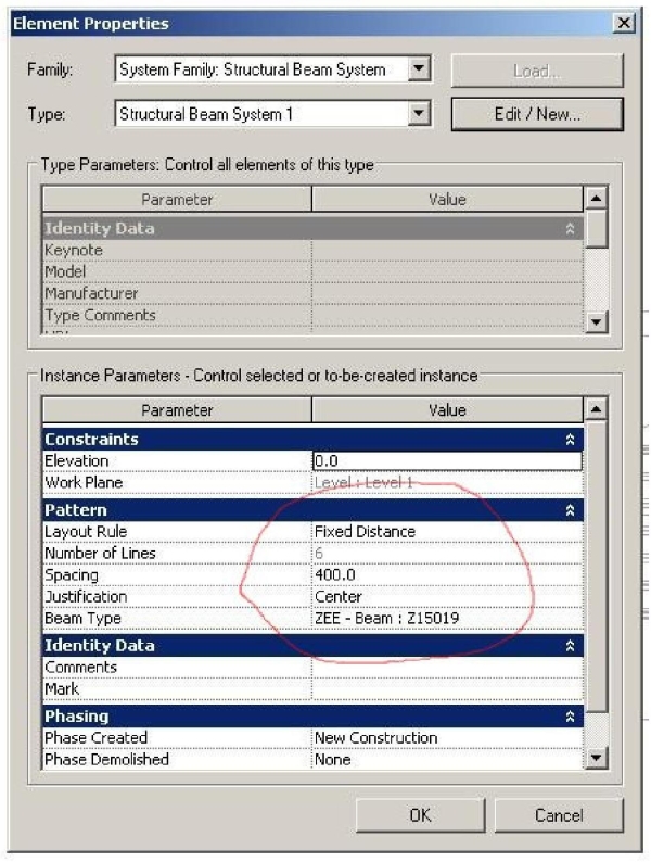

Now, click on "structural Beam" and set your parameters, I’m going to use a ZEE purlin for my louvers, but you can easily create what ever beam you want using a new Structural Framing family.

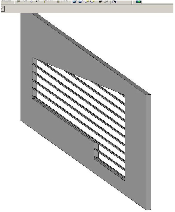

Click ok and finish, you should have something like this:
