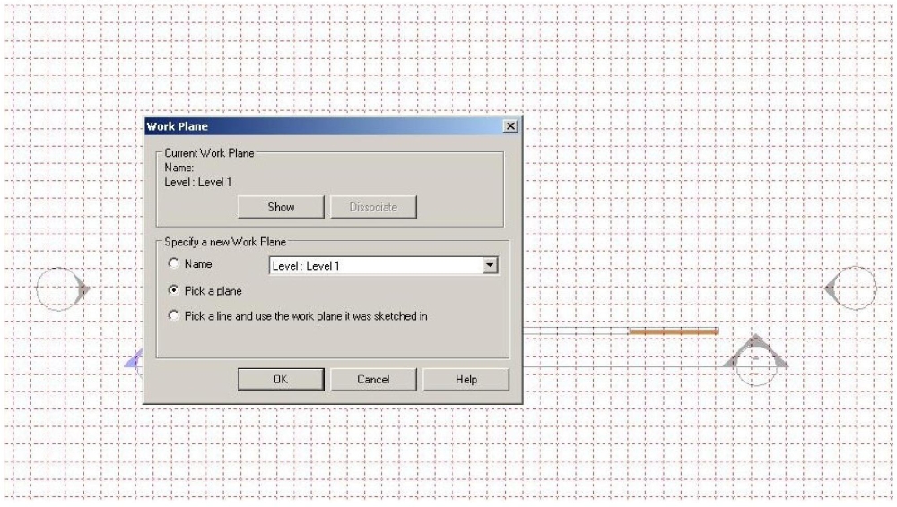

From the "Structural" tab on the left click on "Beam System" and than click on "Set Work Plane"
(click to enlarge)
In the dialogue box pick "pick a plane" than click on your wall

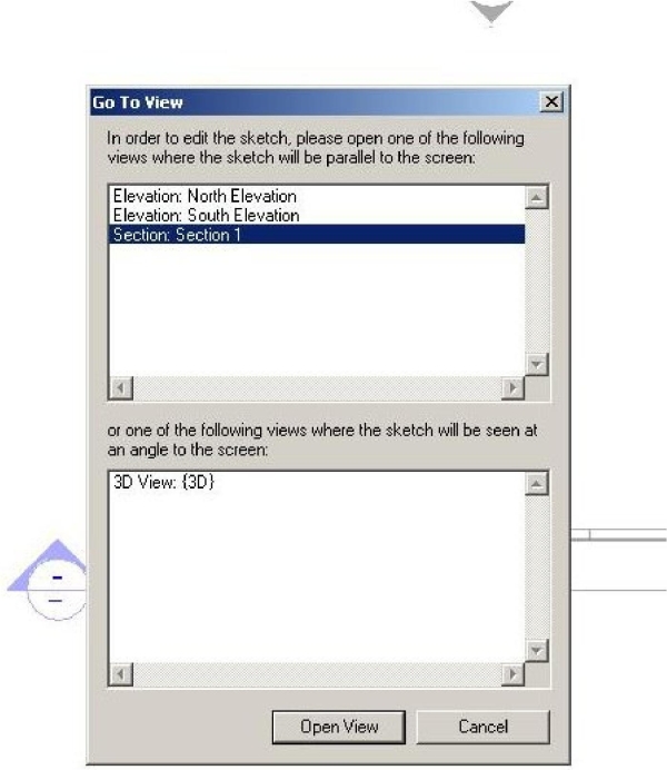

It will ask you which view you want to open, pick the Section you created earlier.
